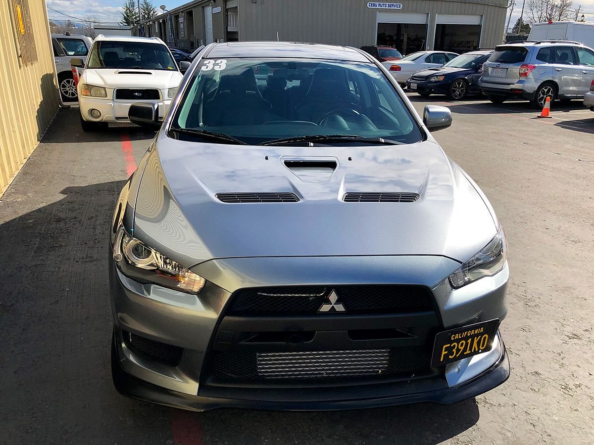

It's all included on the Evo 10 from the factory.
For reference, the front middle part of the bumper cover of my Evo 10 in this photo is all factory. The lower lip and fog light deletes are not as from the factory:
Thank you for the explanation. I have bought a bumper in that same look with everything but in blue paint. I'll have to repaint it but at least the car will look the way it should.
