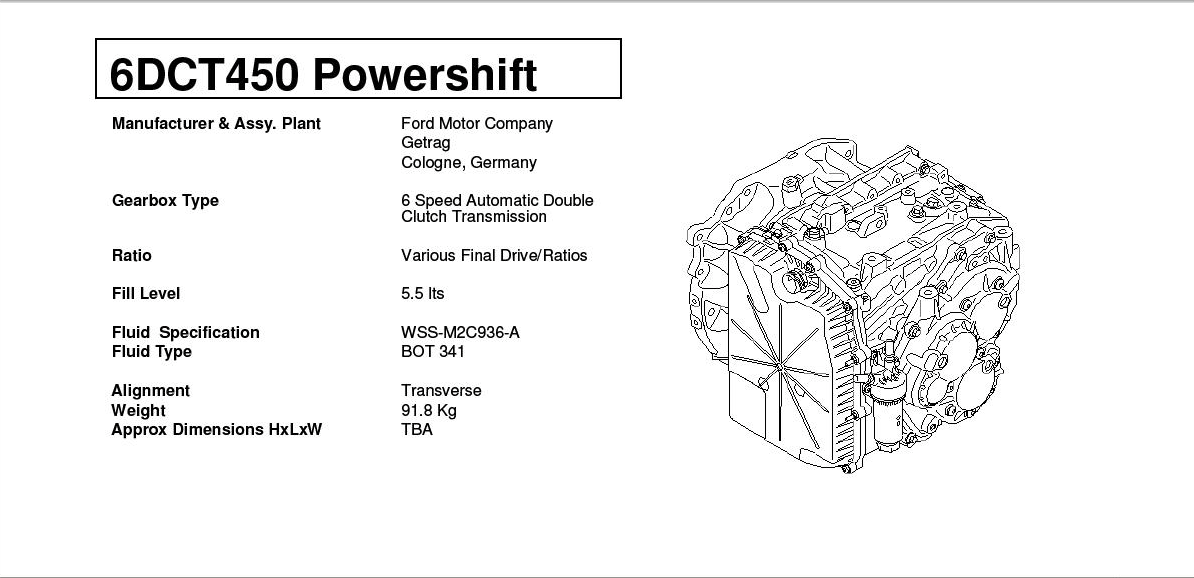

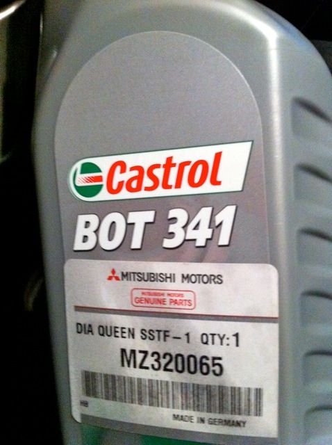

Dude...we know that KOZMIC is the world record holder...can you please stop and maybe read your post AGAIN... you're quoting with regards to FFL series fluids...which are totally different from the OEM fluid (Castrol BOT 341).
I guess you don't understand what Castrol BOT341 is. The fluid i'm referring to is BOT341. which are REBRANDED as DIA-QUEEN, POWERSHIFT, TRANSMAX DUAL, oh...and BOT341 because guess what...the 6DCT450/470 SST gearbox is not unique to Mitsubishi...other car companies use it as well. I guess Mitsubishi calls Castrol up because they're tight like that....and says "hey Castrol please add that lil something extra in the BOT341 so we can call it DIA-QUEEN & charge exorbitant prices...even though the exact same Getrag gearbox is found in other cars...cool thanks bye..." *click*
Instead of blindly quoting something ...maybe do your homework on the product before you go on a bashing spree Please stop replying to this thread if you wish to keep bashing a post which was made to simply share an experience... not cool

CASTROL BOT 341 is rebranded as DIA-QUEEN. There is only one type of BOT341. If there was a difference it will be given a different code like BOT342. How ironic that Ford themselves who make the Getrag Gearbox lists it as Castrol BOT341 along with their own corresponding ford part number.
Or do you believe that...Mitsubishi makes the Dia-Queen for Castrol who then calls it BOT 341...before they sell it off to other car manufacturers *insert X-Files music here*
I think you've made your point... you know more than me Can you please go bash someone elses post.

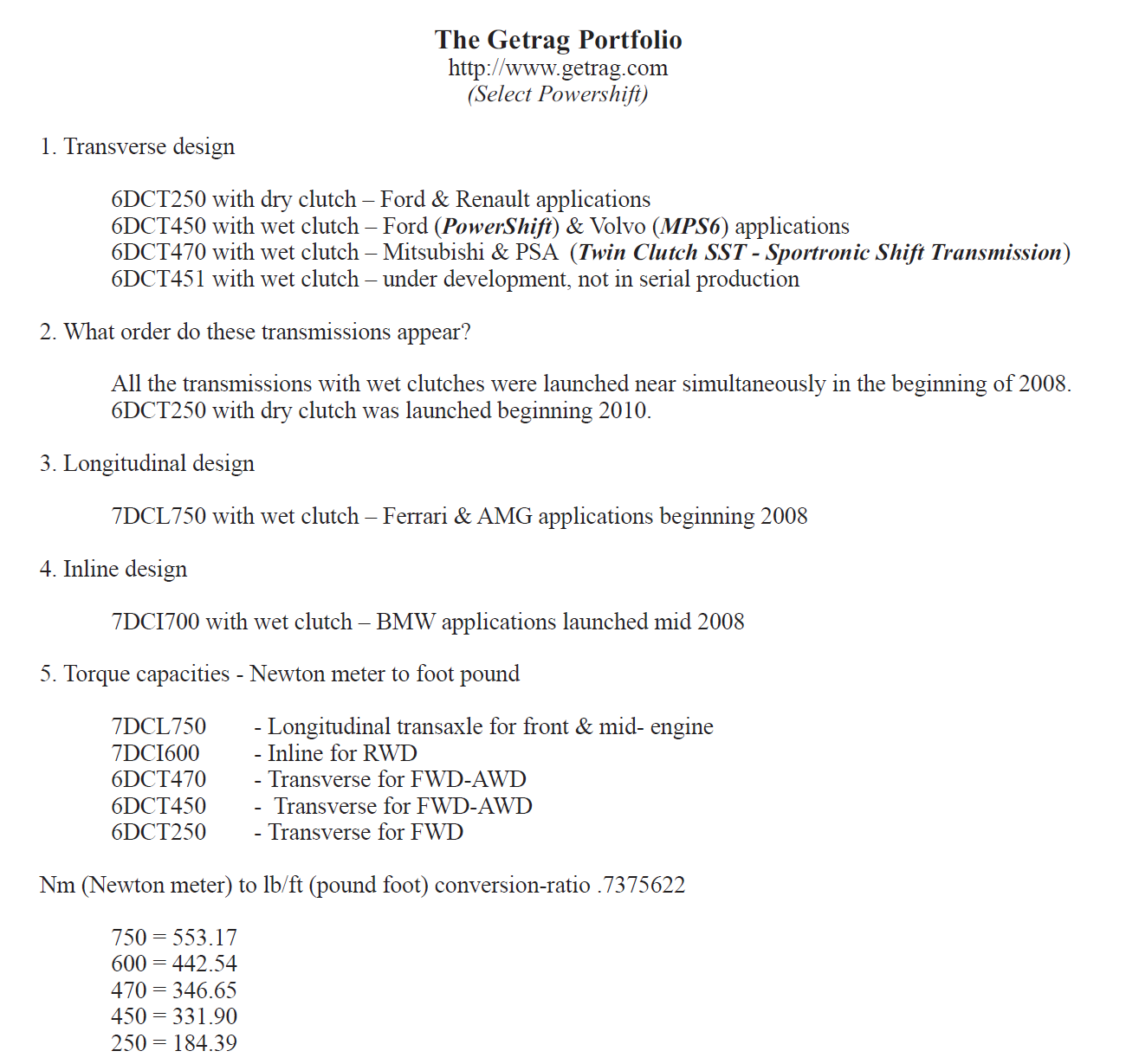

Okay...then who built the Getrag 6DCT470? This is taken from GETRAG.... Do you even know who GETRAG is?
FORD OWNS GETRAG! THEY Build everything made by GETRAG....
All They did was change the clutches from 450 to 470 in the EXACT SAME 6DCT450 & flashed the TCU for S-Sport for the EVO X.
Please just stop....you're hurting my brain with your stupidity.
You've just proven why I say...it's important to do YOUR Homework before you just quote randomly

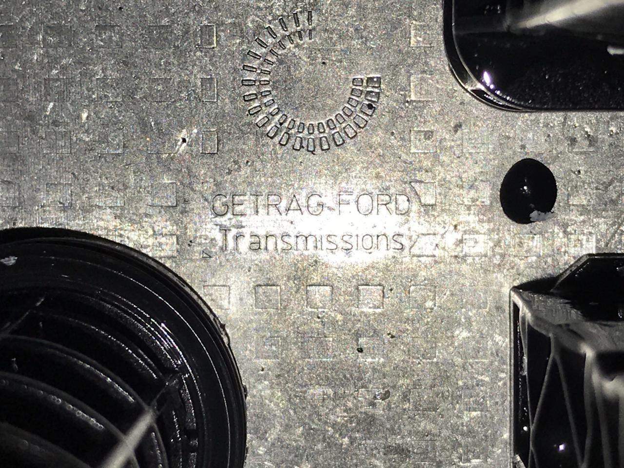

The EVO X SST Gearbox is made by FORD-Getrag & uses the the same 6dct format. Go and look under your EVOX SST & you'll Ford Getrag stamped on the block but the Clutches are different capacities. Please again do proper research before you say Getrag-FORD didn't make the 6DCT470.
Anyway this doesnt take away from the fact that Castrol BOT341 is universal between all the 6DCT450/470 gearboxes and is rebranded by other Car Manufacturers that use the same 6DCT450/470 in their vehicles. I've said this before. This was a post about my experience...yet you contintue to bash it in order to prove that you're right.
So once again please agree to disagree & move on.
