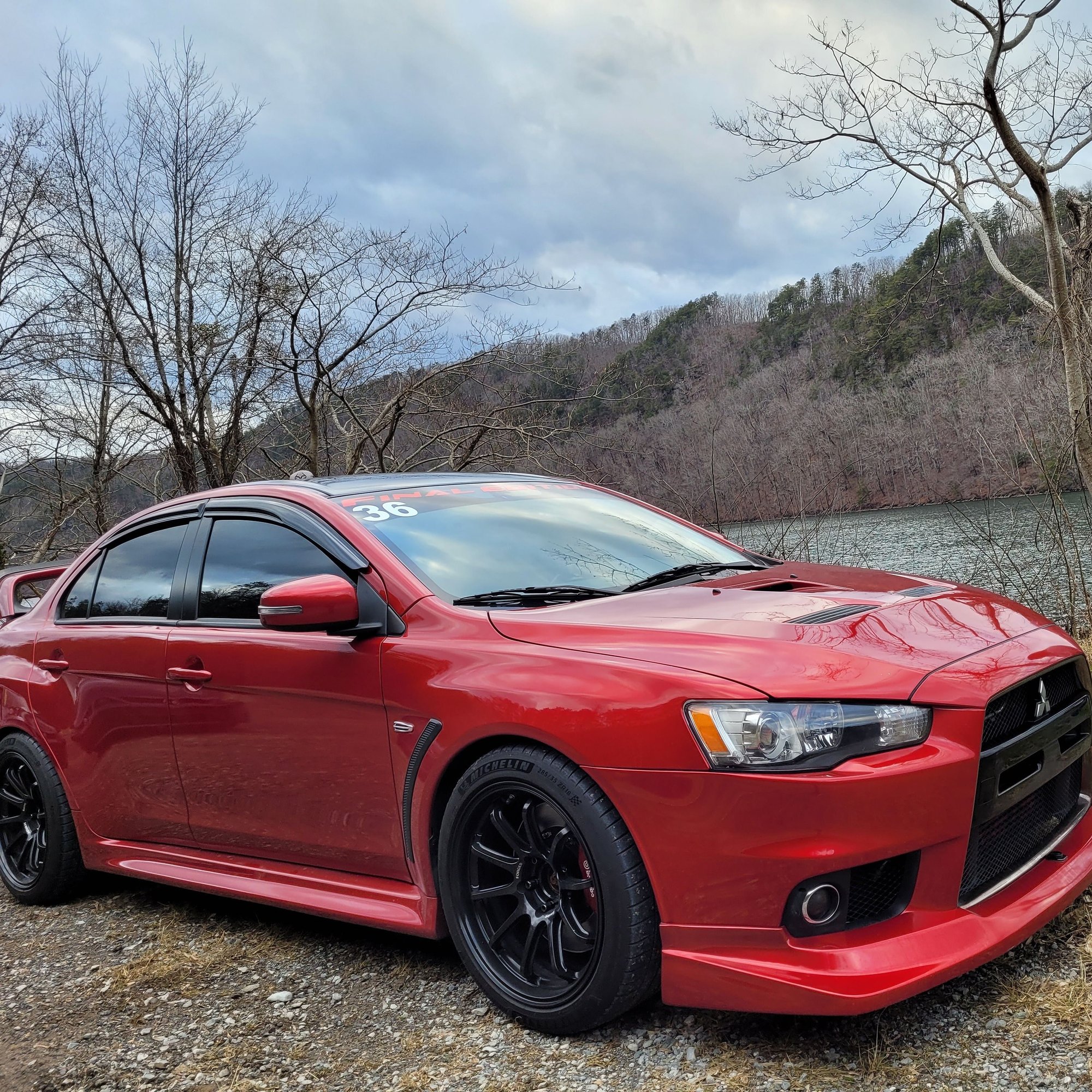

Hey guys,
I just bought me my first Evolution also my first boosted car. The previous owner installed a lot of after market parts and had it tuned at kozmik motorsports in Houston Texas. The black smoke it produces on boost is crazy. The afr is 14.5ish at idle and I think it was 20s in the higher rpms. I'm just looking for some advice on the richness and any other modifications that would be recommended would be greatly appreciated. The mods so far.
Bride Lowmaxx Racing seat
Evasive motorsports Seat rail
Ohlin R/T coilovers
ETS V2 Extreme Turboback exhaust with HFC
ACT 6 puck clutch
Fidanza pro-lite flywheel
Advan RSDF Forged 18X10.5 +24 offset
Michelin Pilot 4S 285/35R18 (all 4)
Hawk HP + pads with Brembo brakes
Turbonetics Electronic boost controller (3 way)
BOSCH Injector Dynamics 1300 CC injectors
Fully Custom Carbon Fiber Weel from NRW (NELSON RACING WHEELS)
2 POD pillar for Guages
Innovative motorsports EFC-1 Guage, ALL in one- ETHANOL guage, A/F, FUEL pressure and fuel temp
Innovative Motorsports Boost Guage with shift light
Extreme Turbo Systems (ETS) Intake with MAF
Walbro 450 fuel pump.
Thank you again. No trolling would be nice 😁
