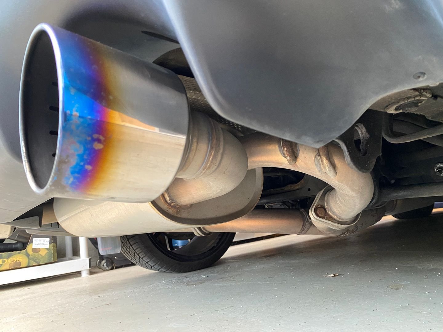

Those aren't cats, they are mufflers. A cat-back replaces everything after the catalytic converter.
The first has larger piping and tips, with the single muffler.
The second smaller piping and tips, is lighter and has dual mufflers.
If you like HKS and the dual look, maybe consider this one:
https://www.maperformance.com/produc...xoCrcwQAvD_BwE
I've had it on my X for 7 years. It will save you some money and should flow better if you add more power adders down the road. It is probably a bit louder also.

Only thing to watch out for with those "JDM" exhausts if you winter drive your Evo in the rust belt (yikes) is they rot out as fast as the car does. There are a bunch of better options out there for durability.
For winter driving, I went with Ziebart undercoating for my Evo X and it has worked out well so far.
