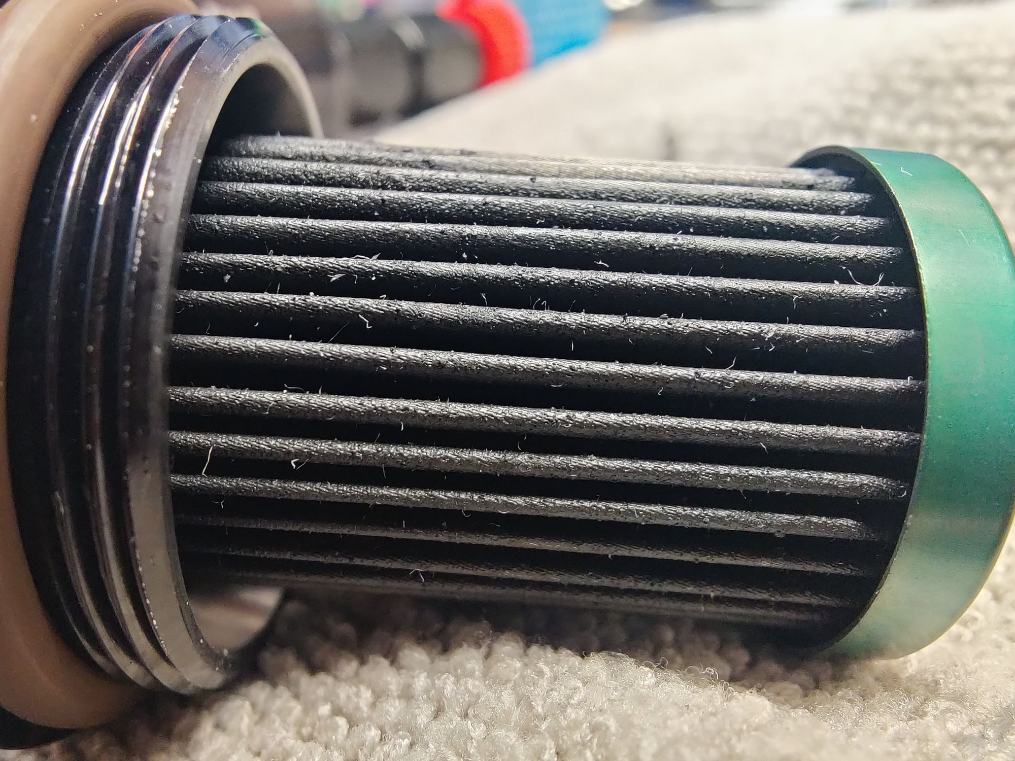

Hey guys, Having issues building boost getting past half throttle/10-15psi boost. I'm sure this is fuel related but I'm lost as to where. forgive me if this post is kind of long but I'll start here:Mods to the fuel system:
  1. id1300x
  2. Fuel lab mini AFPR
  3. AMS rail and dampener
  4. 10 micro inline filter ,
  5. stock fuel lines, Bulletproof dual pump hanger (running single 450)
  6. Hardwired and relayed running 13.5-13.7 volts constant
Everything was running tip top of a hot second after installing my last mod being the double pump hanger. I did this because I was tired of how finicky the stock hanger was running a 450 and kinking the lines on and off. One day, car was struggling to start and hold idle, drove like **** and wasn't boosting over 10-12 psi. turns out the fuel filter was clogged to hell from 1 year of e85 here in SoCal:
cleaned the filter, car is running **** again! untill...she didn't lol. Went to idle the car, and she died after 30 seconds. I had to plug one of the pump spots since I am still only running 1 pump in a double pump hanger. I had put a brass plug with a fuel line clamp on the hose for the second pump, and the pressure caused it to pop out and fly around in the fuel bucket. So I dove back in there, used a nice long bolt as a plug and secured it again so just the 1 pump feeds.
After plugging the second pump feed, and wrapping it all back up together, the car can't run right. it's holding fuel pressure super stable at idle, I set it to 50 psi base pressure with the vacuum line off and it drops to about 43 when reconnecting the vacuum line so everything seems fine there...
I bought 20ft of -6AN line and fittings to see if maybe the feed/return lines are the issue but I am doubtful since she WAS technically running fine before my first plug popped out.
Any ideas, advice, or simple tests I can try are much appreciated.

How did the pickup sock filter look? Did you have any rubber in the tank that might have degraded and clogged up that inline filter? (Just looking at your port plug hose) There's a chance that whatever messed up your filter is gumming up your injectors.
pickup sock was clean' had a little "dust" on it , looked like a couple brass flakes from my plug probably bouncing around very briefly. checked the filter again after slapping this back all together and it was still spotless.

Problem Solved*SS fuel filters, all though claim are "cleanable", mine was like a solid wall when trying to push 100psi from an air compressor through it. Do yourself a favor and avoid Turbosmart / Speed flow filters like the plague. Injector Dynamics F750 is the only viable option that lets you know when it's plugged and gives you pressure differential as an indicator. Thanks for those who stuck with my madness
