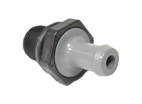

Check the pcv valve

Got new Pcv valve, injectors cleaned, and a smoke test for vacuum leaks found about 3 vac leaks fixed 2 of them there’s one large one coming from the exhaust manifold side I was thinking the manifold is probably cracked but didn’t see any and can’t seem to locate the exact spot of the crack but definitely gonna get a new manifold soon
