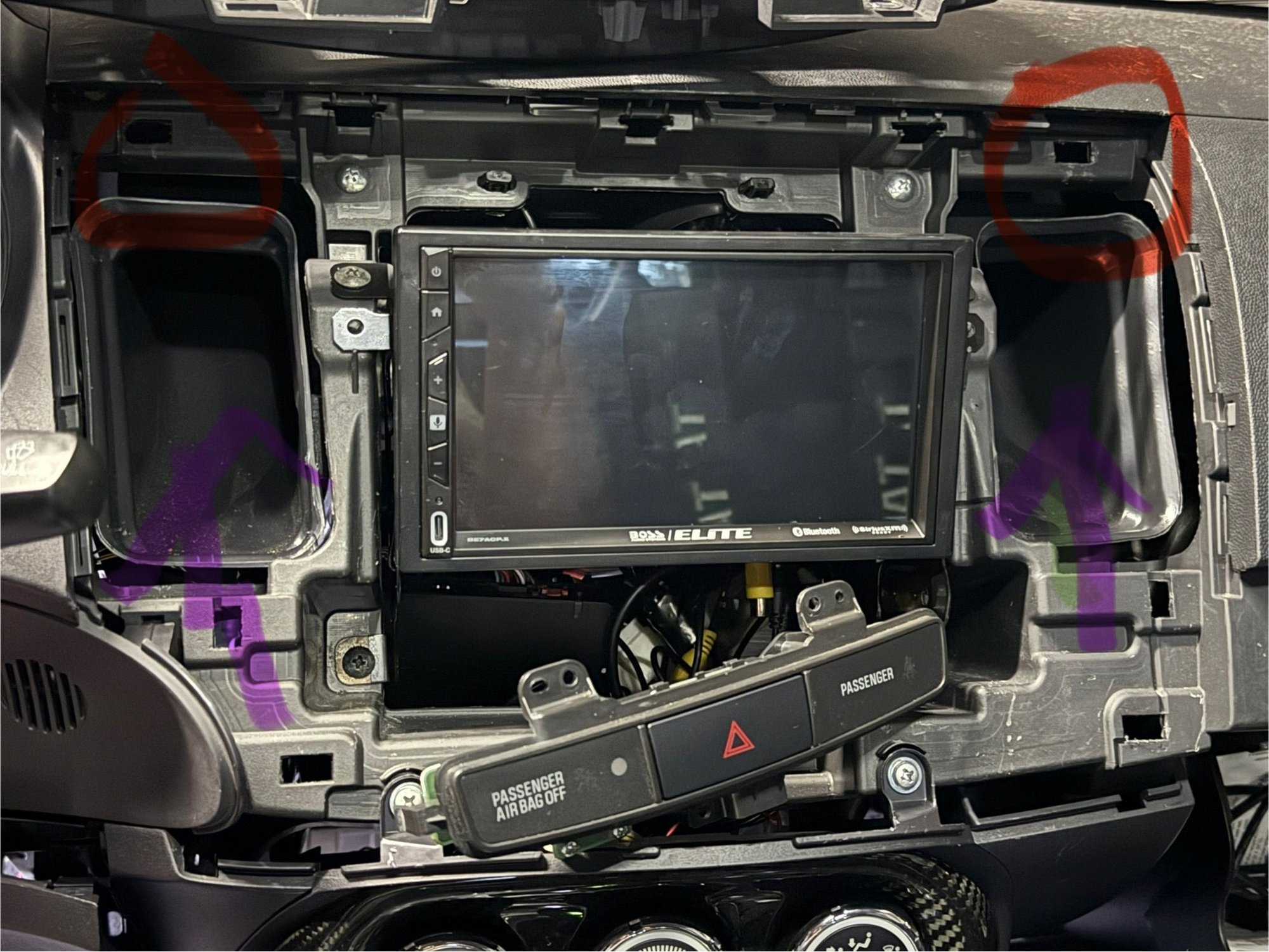

so I looked inside the vents there is no way the clip fell inside because it goes up where I circled in red is where the clips fell behind there I looked everywhere in the back both sides and I couldn’t even find the clips in the back anywhere . So where did they go? And why would it make that clicking noise twice ?. And had like burning smell?? I even looked inside the vents even when ac is on and like I didn’t see any opening and such
where is that damper door?

it fell behind where those red circles . I looked everywhere with a scope couldn’t even find the damn clips. Where are those blend doors located behind there so i can look and see if it’s blocking it
I checked inside the actual vent and I couldn’t see anything in there but the vent kinda go up like in the pic so there is no way the clip went up and then fill down the vent if that make sense
