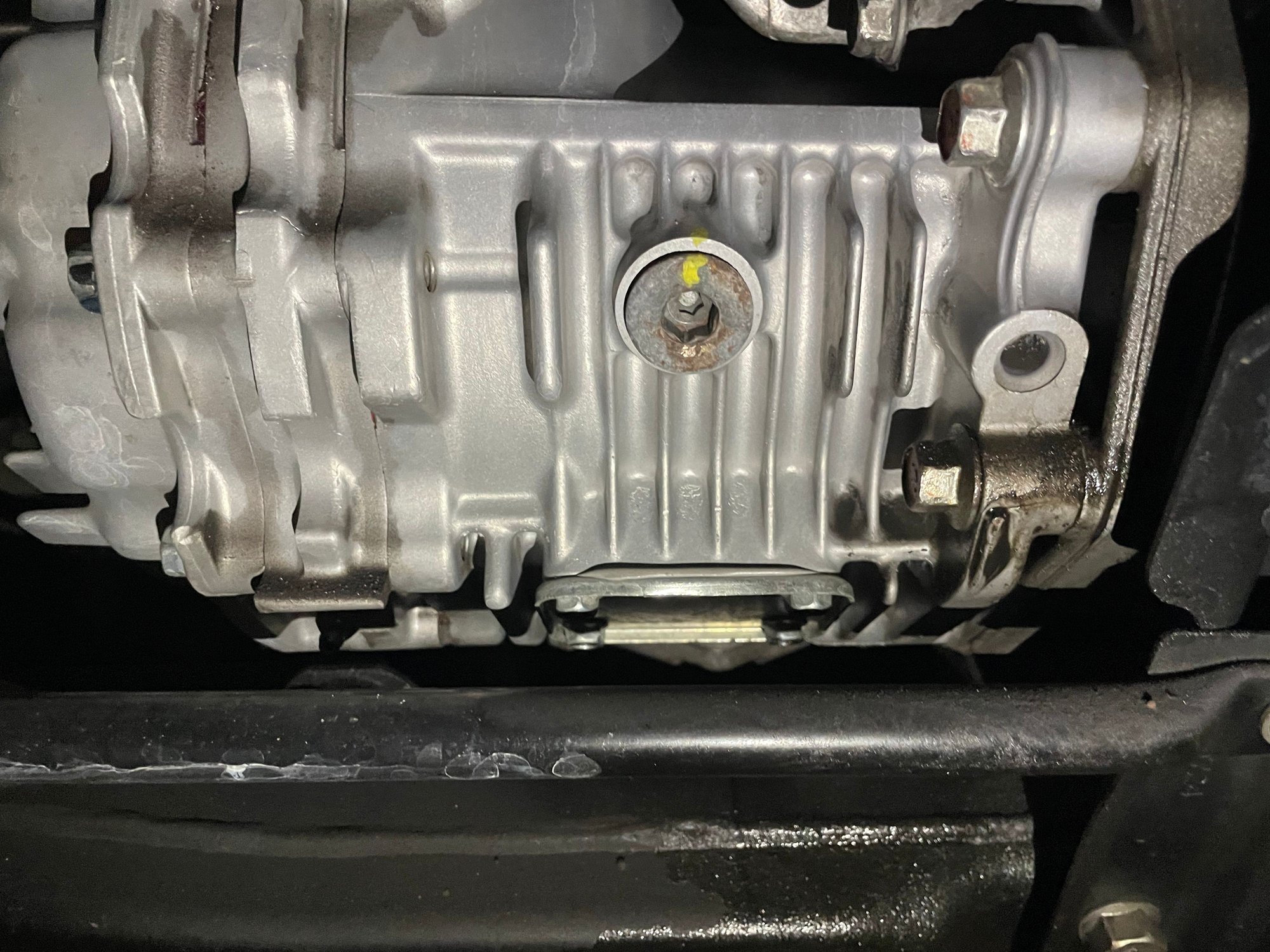

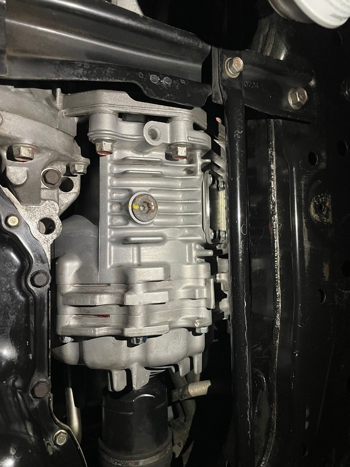

Anyone have any idea what might have caused this leak. My tcase is showing a little engine oil gathering after driving.
i have a 2010 evo x se and the timing chain and guides where upgraded since it carried the old chain.
after installation no noises and car drives fine. I noticed a little wet spot by the subframe and tcase so I cleaned it off.
I will be checking it again this weekend after driving it for the week.
I will update this post once I do so.
a very reputable shop moonperformance did the work for me and said I can bring the car back if any signs of leaks. I plan to do so if it continues to show this sign even after cleaning the area.
any ideas where this leak might be from?
Before I cleaned it
Before I cleaned it
Cleaned
Cleaned

on a CT9A that would be the small oring. you can ask them if they used RTV

It’s an evo X. Is that a similar setup? They used rtv I believe as well.
