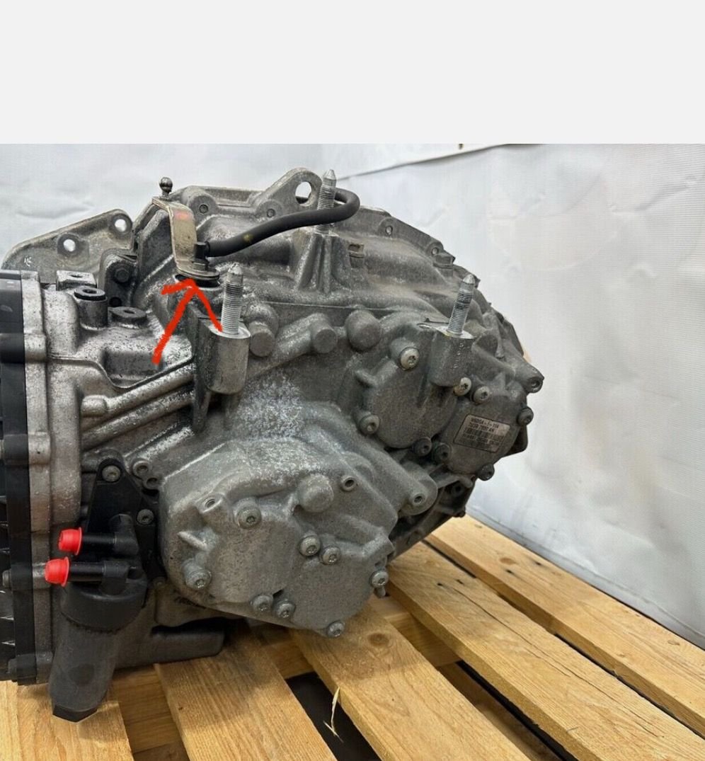

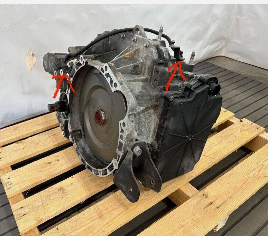

So I recently got my transmission swapped in my evo x mr, and they hooked up the line from the transmission vent to somewhere on the intake lines. I’m assuming this is the incorrect spot, and was wondering where it hooks up to. I have some pictures with arrows of the line I’m talking about
My line doesn’t have this plastic clip on the end

I posted in the other thread too, that line does not physically connect to anything, it vents to atmosphere. Mine hangs off the "back" (closest to the firewall) and points downward. One of the brackets on the trans has a little fitting to hold the hose in place tho.
