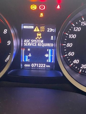

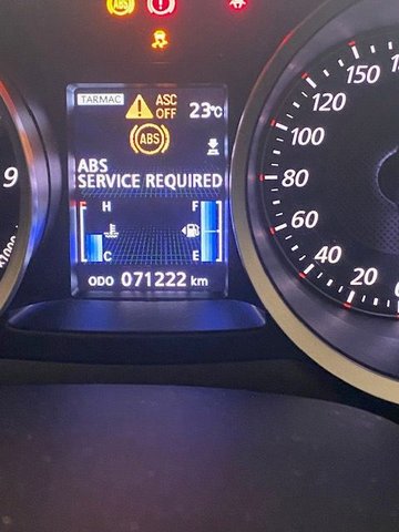

Hi all. My 2010 Evo X has done 71,000kms. For no apparent reason the ABS and ASC warnings appear randomly and are not there every time I start the car.
Any ideas?
Many thanks

So this could be quite a few reasons.
does the light come on once you start moving forward?
best thing to do is get it scanned, so you know which code/sensors involved.
it could be your wheel speed sensor all the way to your abs unit failing. ( or simply a bad electrical connection )
the car can drive with these lights on. No harm done. But get it scanned first and report back
