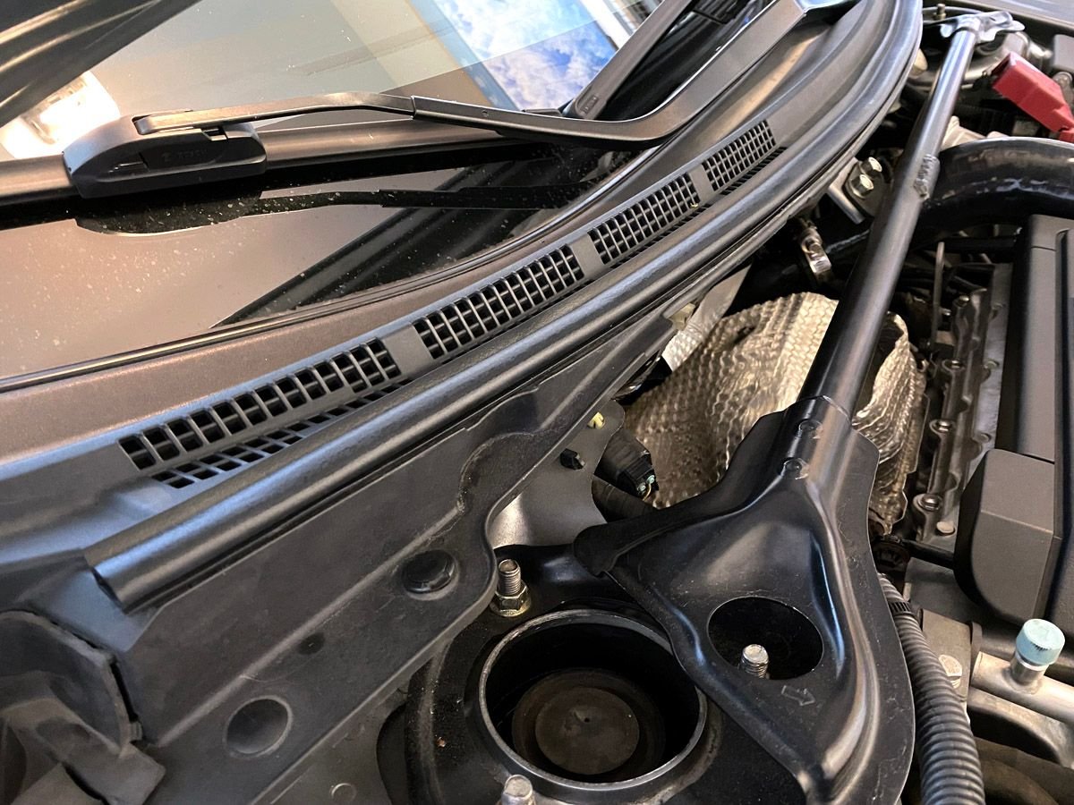

Replacing Evo X's weather strip in the back of the engine bay
I also used the opportunity to replace the weather strip (a.k.a. the rubber seal) in the back of the engine bay. The OEM part number is 5902A020. As I ordered it from Mitsubishi, this part number comes with all the necessary plastic rivets pre-inserted into the strip. How generous, Mitsubishi?!
My old original rubber seal 5902A020 was torn. Surprisingly it has not lost elasticity for 10 years of service, likely because it's not exposed to UV. Upon inspection, I believe the cause of it being torn is the rubber drying out over the years. Without the oil inside that prevents the rubber from sticking to the hood surface, every time when the hood is opened, the rubber gets lifted forcefully by the opening hood. This eventually destroyed the plastic rivets and tore the rubber seal.
To protect my new 5902A020, I grabbed a bottle of DuPont Surface Safe Silicone Lube to keep the strip lubed. Hopefully the weather strip doesn't stick to the hood surface again.
^New Mitsubishi OEM rubber seal in the back of the engine bay 5902A020 installed.
