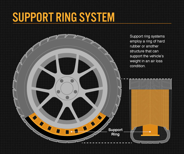

I recently rode a law enforcement vehicle equipped with run-flat inserts. The ride felt almost(?) as comfortable as a GT-R with stock run-flats. My understanding is that, unlike run-flat tires, run-flat inserts work with normal tires which have sidewalls much softer than those on the run-flat tires. Also, run-flat inserts are slightly smaller in diameter than the support rings that come with run-flat tires, so the ride quality is not heavily compromised.

(Pictured: Bridgestone support ring system.)

On an Evo you'd burn up the driveline if you drove for very long/very fast on a single runflat. You aren't supposed to drive with uneven tread depth let alone how far that tire will sink if it's running on that support ring.
