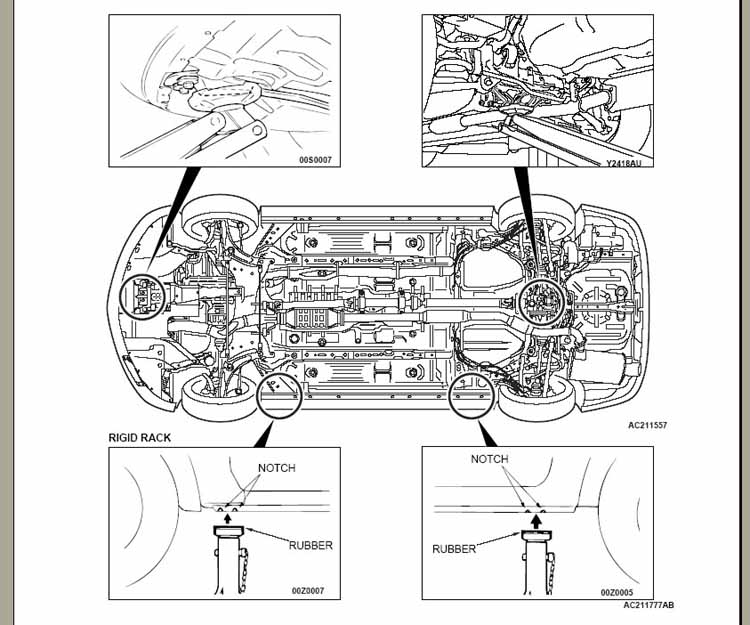

hi i'm at 4000mi and im gonna rotate tires and change tranny fluids at the same time. only thing is im not completely sure where to put the 4 jack stands. And can i jack the car at the ends (so i can put 2 under) or do i do each corner individually. plz dont flame me

This should help. https://www.evolutionm.net/forums/at...chmentid=65696 &
https://www.evolutionm.net/forums/sh...ht=jack+points

thnx dude, i didnt see that in the howto's
