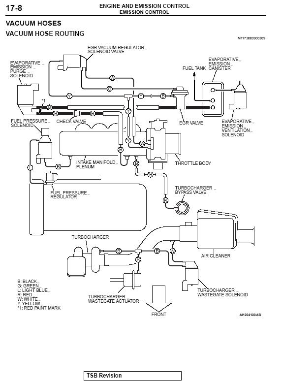

Does anybody have a copy of the vacuum diagram my evo 8 did not come with the stock hood so I do not have it
Having boost problems not sure if the lines to the boost solinoid are hooked up correctly
Already done the boost leak test

here are some pics to help you.
these are the stock lines.
The line with the red tape connects to the wastegate.
boost control soleloid located right underneath the stock airbox.
The lines you see are the stock lines.
