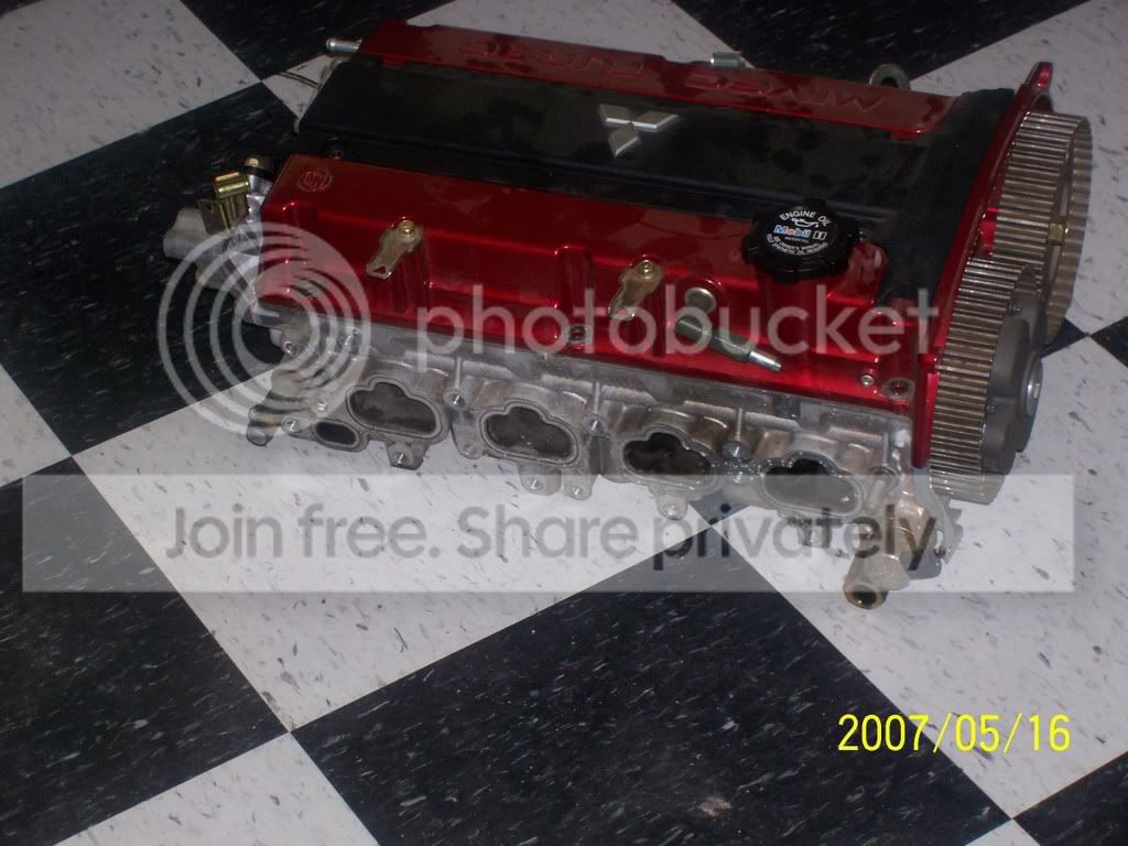

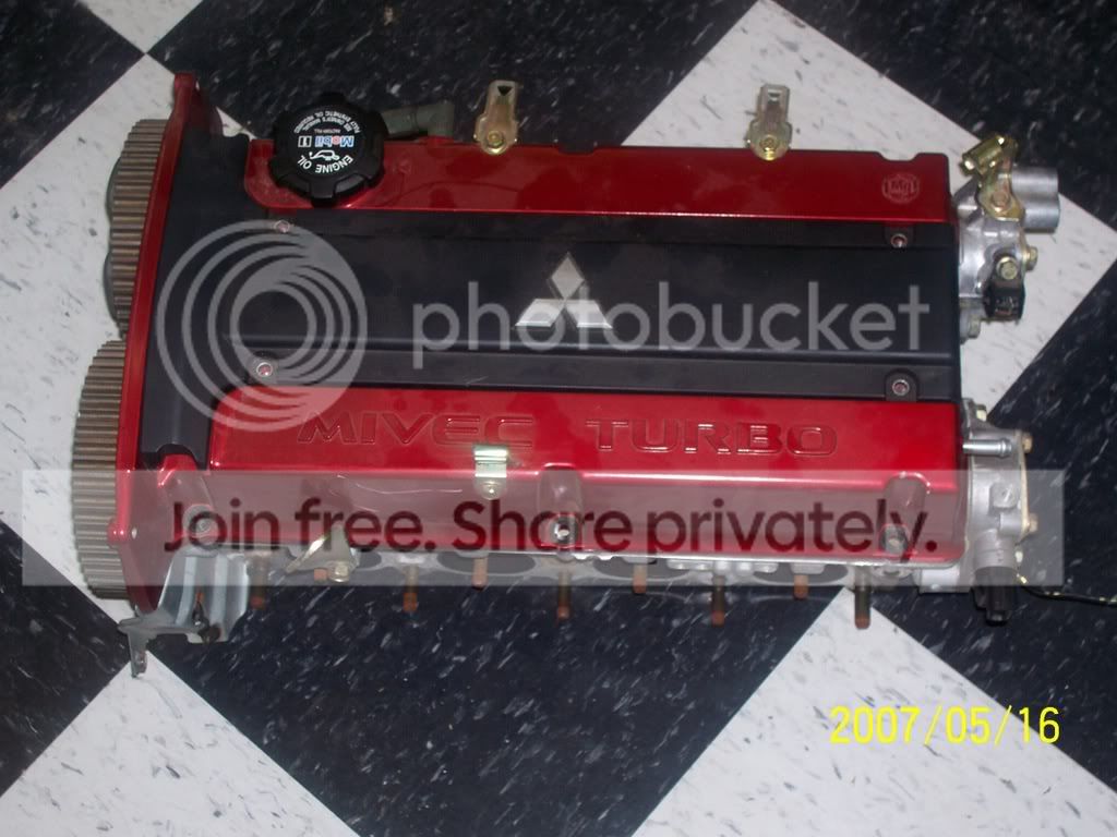

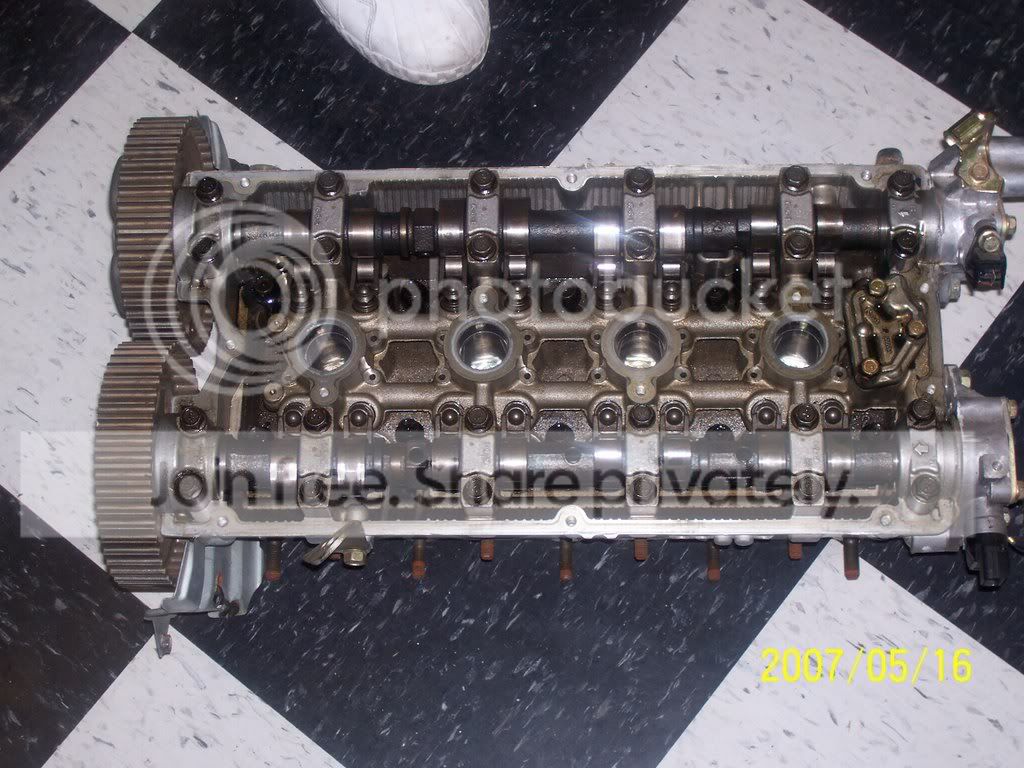

ok guys I have an 01 eclipse rs
as you guys know it comes with a 4g64 and you can do the evo swap on it.
ok well I found a head and the guys selling it say it's off an evo VIII but I didn't think the evo VIII came MIVEC but could they have done a Valve cover swap?
Will a EVO IX valve cover fit and EVO VIII?
here r some pics of the head.
Like I said I'm new to EVO's and I keep on searching for the answer but It's a pain with all the Posts that come up so I decided to post in the Newbs forum

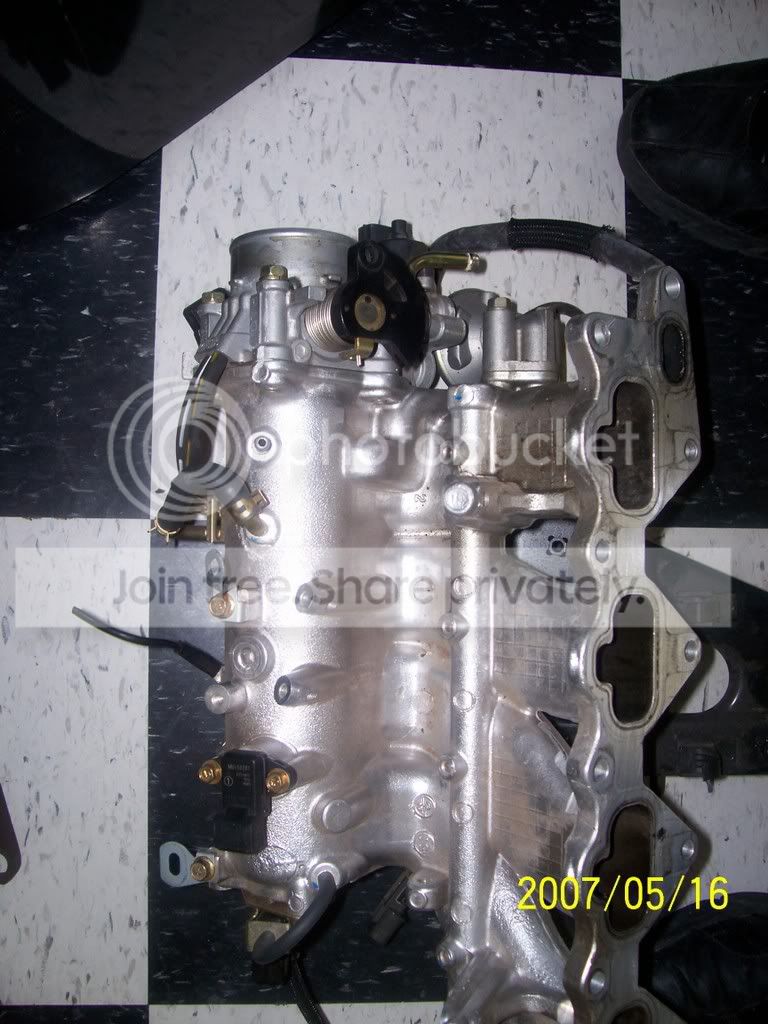

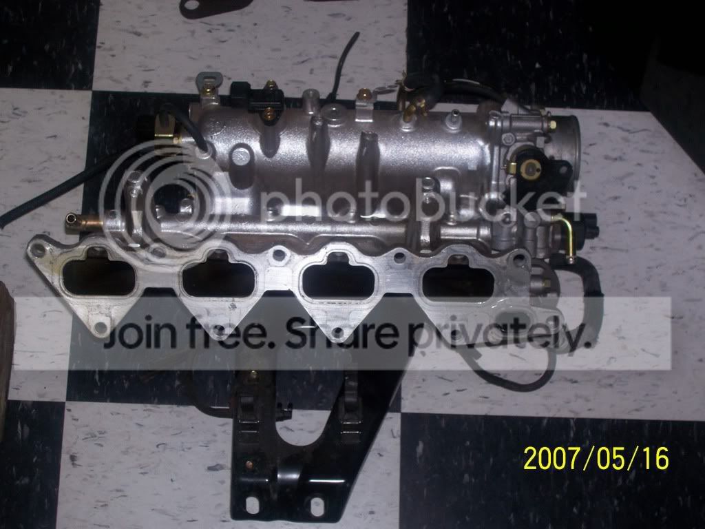

Intake Manifold

That is an Evo IX head....

can you tell me how you can tell?

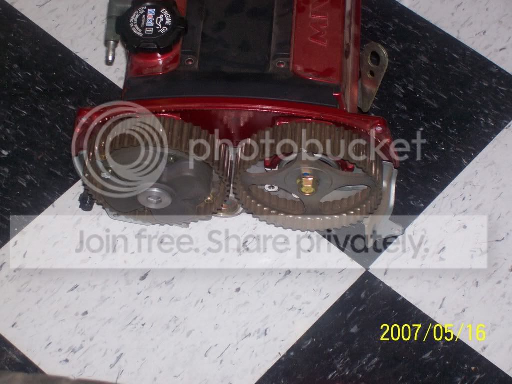

yeah looks like an IX head... look at the cam/cam gear on the intake side... it has that one thing that protrudes for mivec (??)...

deff a IX head. You can tell by the timing spool on the intake cam gear and the timing/oil diverter plug under the intake cam right next to the 1st cylinder

it's an IX. look at the mivec intake cam gear cover. for god sake, it even say mivec on the valve cover
