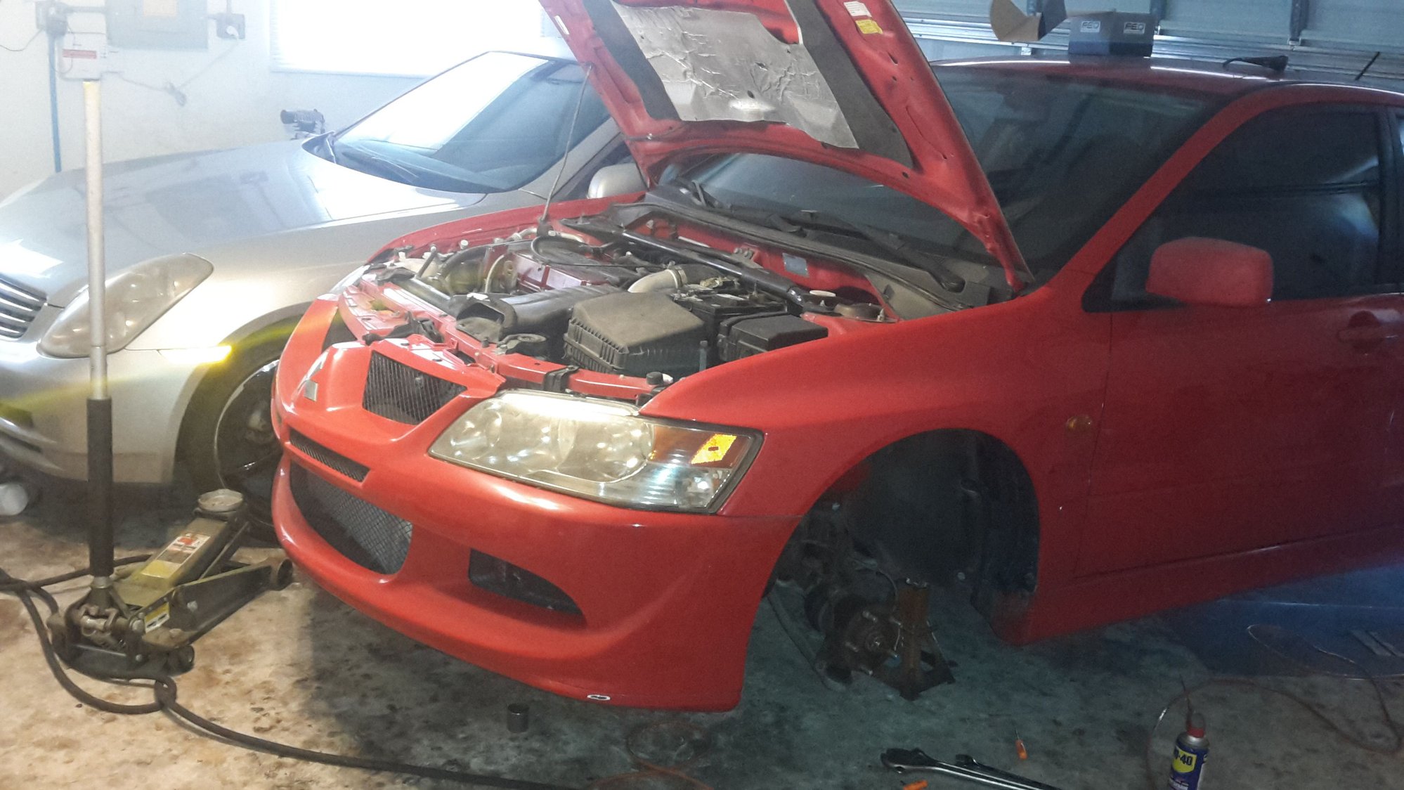

Problems are
Clutch
Both front hub bearings
Acd all lights lit up
All stock
95k miles
Up north car last owner just drove it
Was traded in at my store
No history on car
Old Jul 10, 2015 | 05:36 AM
05evo8red's Avatar
Joined: Jul 2015
Posts: 22
From: Florida
Cv axles are frozen in

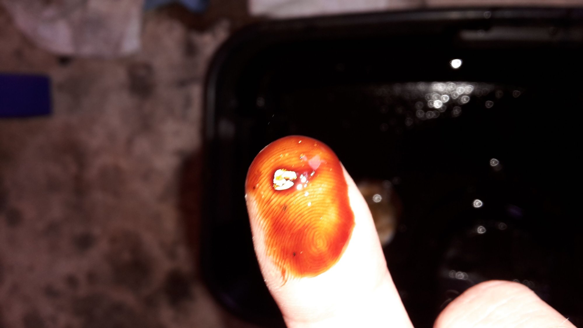

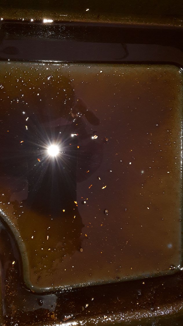

Yesterday I got the hub bearings. New axles in .put the car back together, change the oil an found gold metal shavings in the drain pan. When I got I drove home easily because of the clutch. So yesterday I changed oil took it for an 30min drive no oil light no rod bearing noise nothing I'm starting to not like this car lol

An I know this didn't come out of my cobalt ss. I redline a few times yesterday an ran it over and over. Seems to be fine

If I put a set of rod bearings in this .will the motor hold up for a while

IMO If that metal gets up into the bore, valves and turbo you might be kissing that motor and more good bye
So If it was me I'd be doing a full pull down and hoping my bore and pistons are ok. Remember you got it for 10 grand, mine cost 3 times that.

I'm going to pull the pan today and see what's up the motor runs like it's new no knock nothing no oil light. I drained it again an nothing in the oil. If it's running fine what else would would come apart in side the motor is quite you can only hear the injector pulse

Yea I would change out the bearings. You can have the oil tested just to see what material that metal is.
