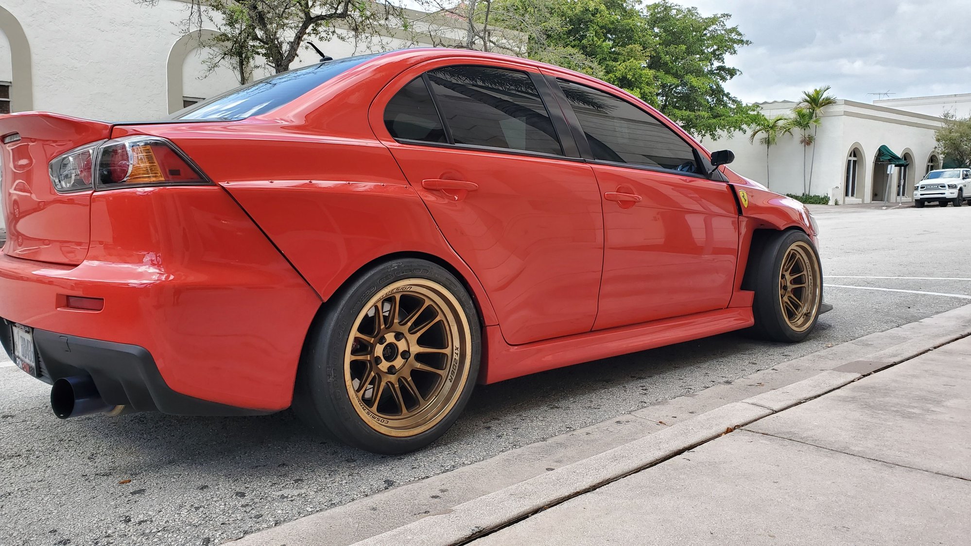

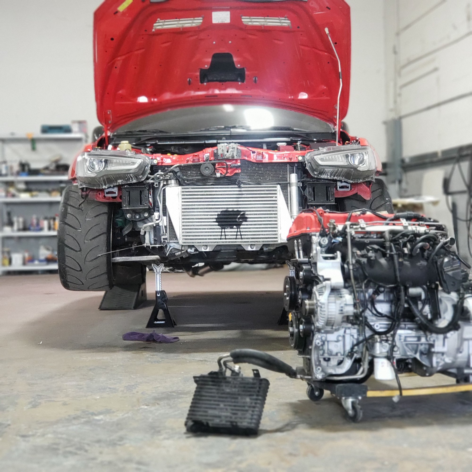

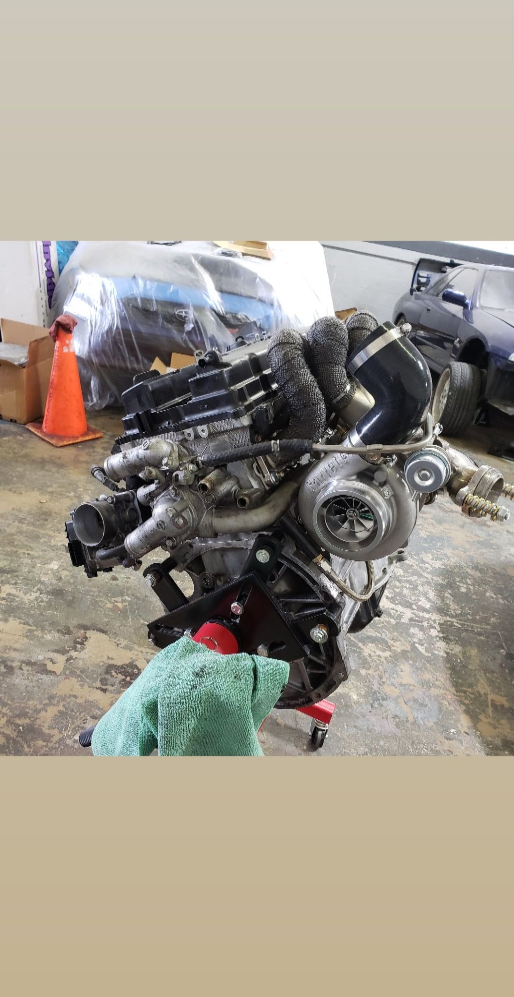

New to the forum. Built evo x by Ferrari tech
I've had my car for 5 years
started out white
Painted it rosso scuderia
made 430 on stock motor stock turbo just bolt ons.
blew it up and went simple build with stock frame turbo garrett 3582
golden eagle sleeves
cp pistons 87mm 10:1
Manley tt rods
arp everything
kelford C cams
supertech dual valve springs.
Supertech valves
port head
TS ex cam gear housing
fluiddamper crank pulley
Hyundai metal pulleys
Id1700x radium rail
walbro 525
Tuned by slowpoke and made 565 on 28 lbs for now will go up in boost when this Corona is over
tein coilovers/ whiteline sway bars and endlinks
Chassis has 97k miles . I drive it everywhere and have no issues with tracking it or beating on It. Its one of the best cars I've driven.
Im Ferrari tech and I pretty much do all the work to my car . Except tune and spraying the paint.
Enjoy

new wheels !
18x10.5 0 offset
295 30 18 r888
