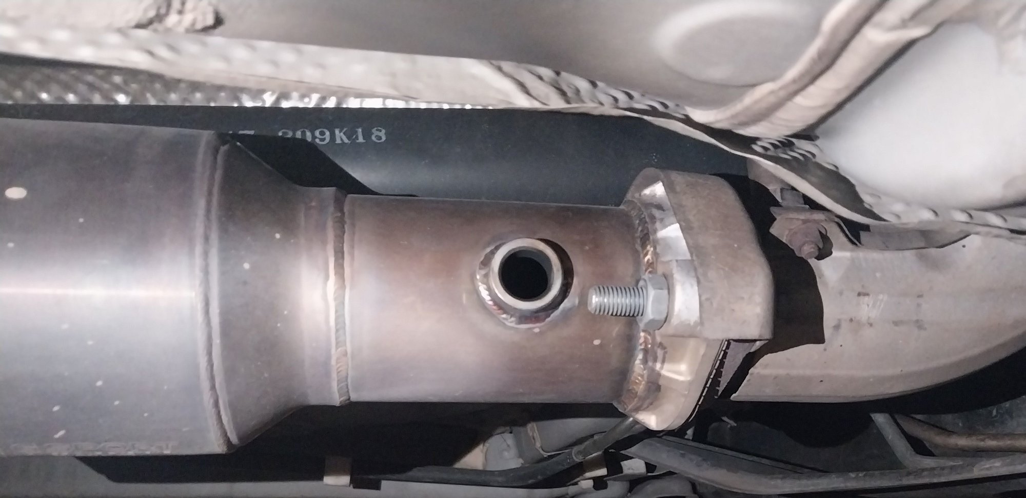

Hi all! I've had my evo for a little bit but not too long, excited to be here! Wicked White 2010 GSR.
Quick question:
This looks intended, but should this be open?

No shouldn’t be open. Probably a afr sensor was hooked up there.
you could put a bolt them to close it out or put a afr sensor-gauge.
also welcome to the evo world ! Any pics of the gem ?

Yup, shouldn't be open. You can find o2 bung cap, put an old sensor it it unplugged, or instal a wideband if you don't have it already.

Wideband if you wanna see the gauge move around. Otherwise just plug it with a bolt for a future time.
