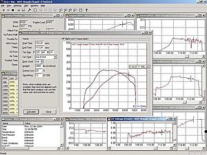

Well, the bad news is that I decided not to implement your suggestion about being able to type in a "go to RPM." The good news is that I decided to implement something better!
On the ECU+ dyno graph, you pull up the dyno graph and there's no cursor, even though the tooltips display the X and Y values. Welp, I added a cursor that works like the cursors in the normal scrollable graphs. But what's cool is that now, when you move the cursor over the dyno graph, the rest of the cursors track it. So, if you move the dyno cursor up to a spot where you have a dip, say at 6200 RPM, the cursors in the other graphs move to the time where you were at 6200 RPM. This highlights *everything* that was going on at that instant without moving back and forth between the dyno graph and the other graphs, and provides an auto "go to RPM" function.
So what you'll want to do is that next time you're on the dyno, bring up the ECU+'s dyno graph. You'll see the same curve as on the real dyno, and be able zero in on those trouble spots using the ECU+'s dyno graph and the new back-cursoring.
It's hard to describe how cool this is in words, but when you use it, you go "oooh."

Excellent! It'll do what I requested but in a better and more efficient way. Same thing when I was implementing business software application, the actual implemetation always lead to better ways to do thing than the analytical planning. I'm looking forward to it. Thank you very much and you have a Merry Christmas.
