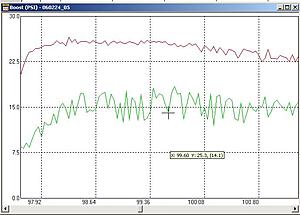

Hi
Hi have a problem with my boost, it fluctuates much more than I would have expected and in comparison to other boost graphs I have seen. I am also not making the bosst I would have expected.
I have reversed the stock BOV and checked all pipes and connectors. I have taken the actuator off and it dose have sme rust, but seems to operate whan conected to a foot pump
Car mods are limited to a turbo back exhaust and walbro pump.
Thanks fo any advice.
MB
Green trace is my car, red for referance.
