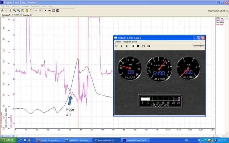

apexi power fc map problem,after instal evo5 power fc to my evoIII,3rd gear WOT run when boost spool up 0-20psi at3600rpm-redline excessive engine knock 60-72count,after retune the ignition map -5 degress,12.5afr 0-10psi,11.5afr peak boost
until 6000rpm 10.8afr,pfc show 15-20count knock,but after tune feel like under power!
(95 octane gasoline,evo6 aif flow sensor,hks264 cam,evo3 td05 turbo)
how do about editing the fuel map and ignition map?
how copy evo3 map to power fc?
