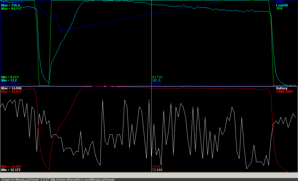

I am searching for a software that would allow for viewing.csv files, something similar to AEMData with regards to their AEM format.
I think virtual dyno had an add-on that could do the job, however, its seems to be laggy when viewing larger files. Any alternatives?
Thanks in advance!
*below is an example of what I am searching for.

I can't see the pic from my work computer, but I HIGHLY recommend MegaLogViewerHD. It's $40, and made by the same guy that does MegaLogViewer for megasquirt. It's VERY well done, and can view many different formats. I use it to view the logs I pull from my OP2.0's SD card logger, and it's lightyears ahead of Evoscan's crappy log viewing.
[edit] just checked the pic on my phone. Yep, MegaLogViewerHD will do exactly that .[/edit]

Downloaded their free trial and its perfect for what I need it for. Wish they had two cursors though to measure time intervals but its no big deal.
Thanks again for the help
