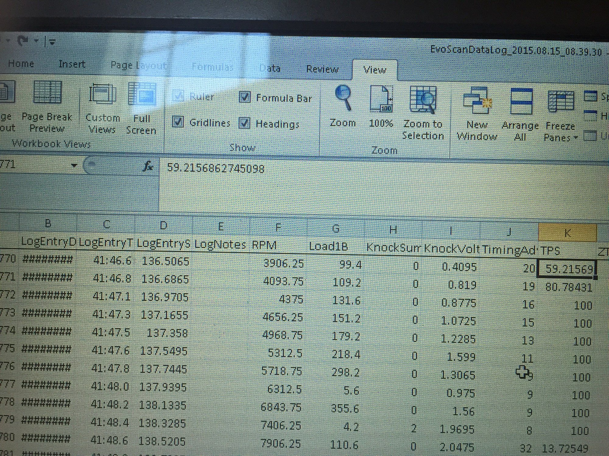

Hello guys,
Below is a pic of one of my logs i am not really sure why but the car is jumping load. Seem to be alwes passed 5500 RPMs and when in WOT. But i can not confirm that yet. It is not my daily and i normaly only have time to work on the car on the weekends.
If you check out the load in the pull it gose 255, 5.6 , 355, 4.2, 110.... To say this is a problem is an understatement.
Car is an Evo8 running V7 94171715 SD, Omni 4 Bar... I will attach my tune that is in the car. Not really sure where to go from here. Or even start to figure out why i am jumping load and it is causing knock. The picture only shows 2 counts but mainly when it dose it 4-6 counts...
