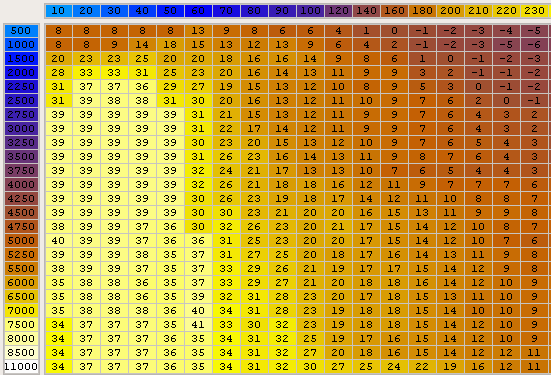

ok off the bat hello everyone. i have had the car from January and i have been trying to tune it on and off because the tune it came with made the afr's drop to 9 as soon as it hit boost. Not saying mines much better but atleast i can drive it to work without throwing knock. im working in jersey city for another 2-3 weeks so i plan on setting up a apt to get a street tune. but i am sure there is atleast a week wait so i am trying to see if you guys can help me out in the right direction.
log is 2nd and 3rd gear i believe. i cut out the inbetween(not in boost) to fit more

A quick thing to change will be the order of things logged in evoscan, easier to reference data that way. Step two will be to log a WOT pull. Your tps is showing 45ish percent throttle. Just make sure your CEL is set to flash if you get knock, so you can get out of it if you need to. Are you running SD? If so, are you using the 3D rpm/VE table? You fuel map doesn't look like it should take you that rich, unless that table is in need of adjustment. Another question, what injectors? If not stock, what do your trims look like? Those are the first things that come to my mind. I'm sure others will be able to help more.

first off hell yes i have thought of that just haven't gotten around to redoing the order. it worked well when i was logging a few things then i threw in alot more and never got to it. i cant do a wot pull as soon as i go wot afr's drop to 9's and ill start knocking. that explains the 45%. yes cel is set to flash, no sd, stock inj's, i know fuel map needs to be lowered in wot but im just trying to get afrs to stay in the 11's for now.(yes in very much need of adjustment(first car tuning) i did check all inj scaling and all is correct.
