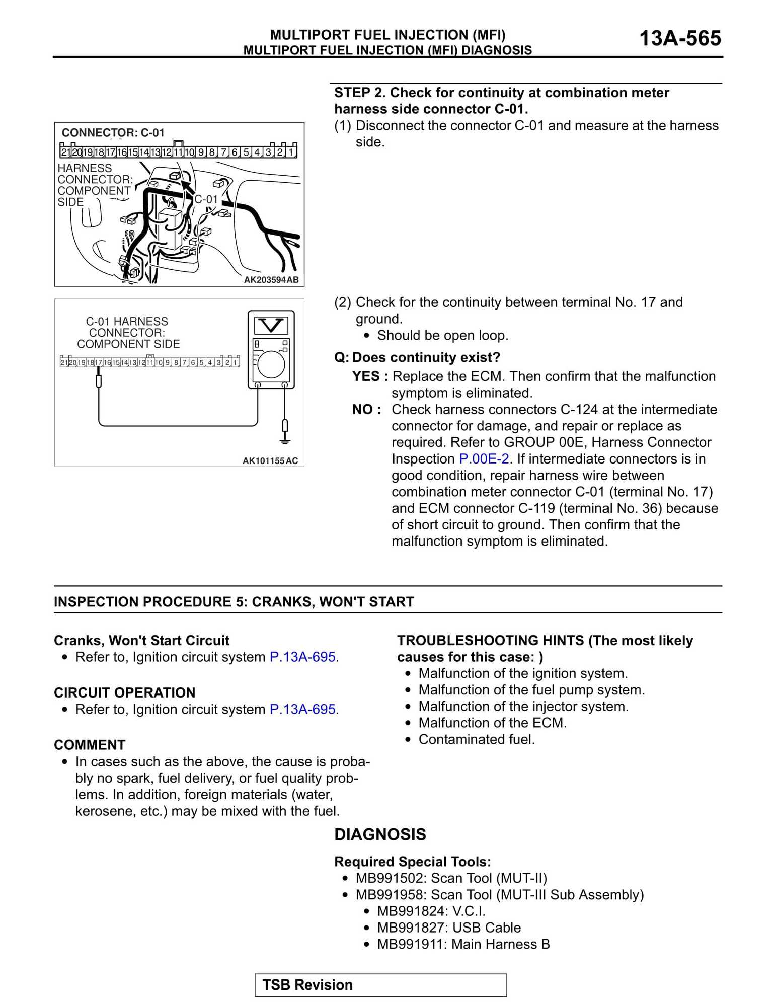

Old Oct 12, 2017 | 08:29 PM
Derekhollister's Avatar
Joined: Sep 2017
Posts: 63
From: North Carolina
Connector c01 is where. Hard to tell
Old Oct 12, 2017 | 08:37 PM
Biggiesacks's Avatar
Posts: 5,690
Likes: 708
From: West Coast
the procedures begin below that part half way down the page. "Inspection Procedure 5: Cranks, won't start"
