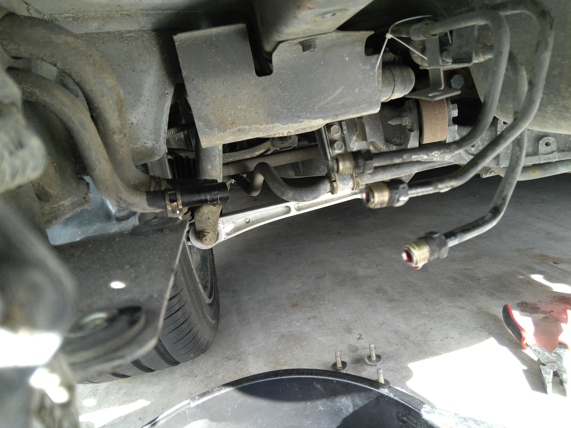

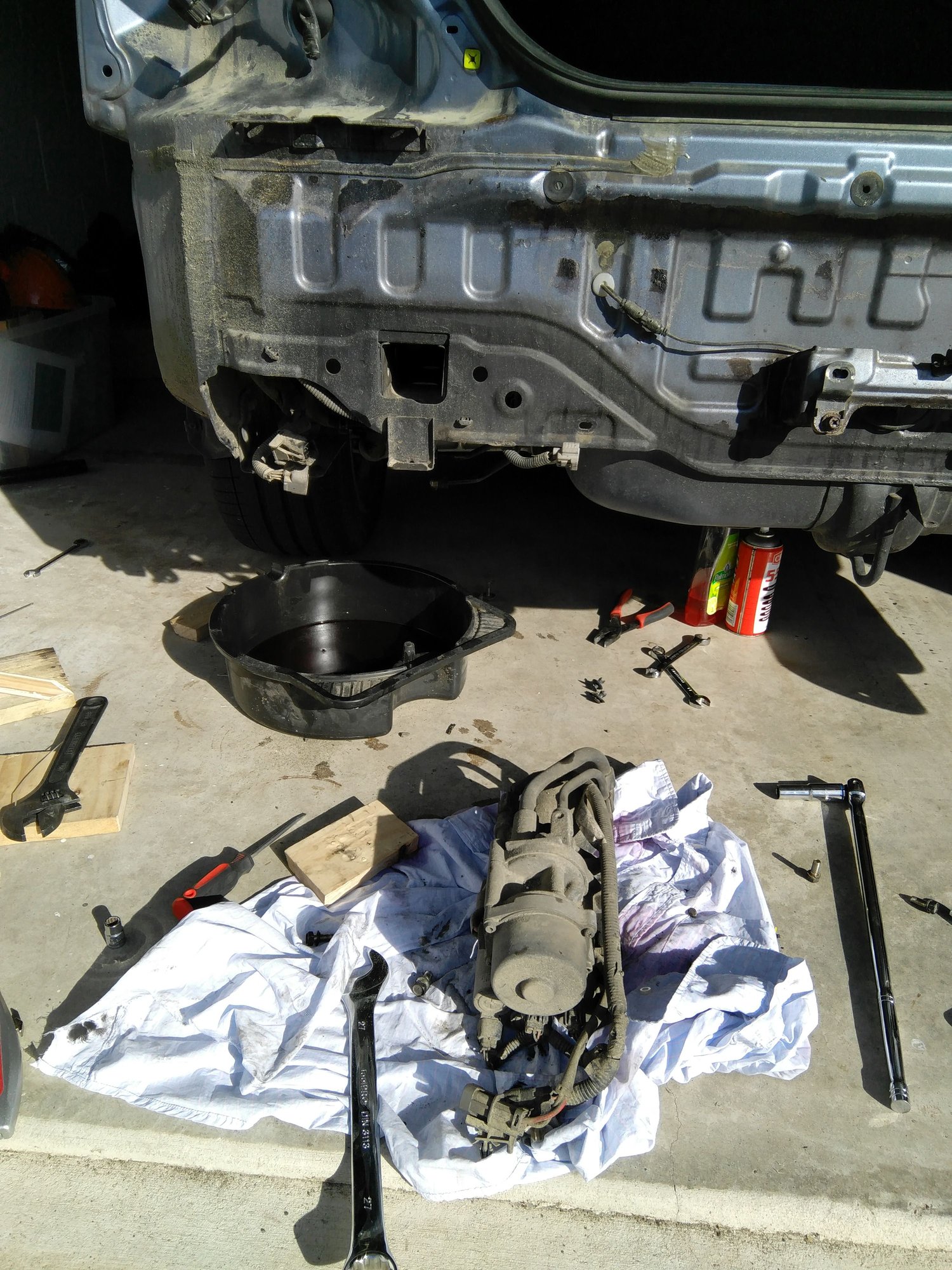

Hydraulic unit removed
Reservoir pipes on the left and left and right AYC pipes and ACD pipe on the right
One more update in case anyone has to do the same: it's all fixed! I have bled the system and the accumulator is holding pressure.
A few tips: Don't try to remove the accumulator while the hydraulic unit is still in the car (on a JDM). Remove the rear bumper and pull the unit out, then swap the accumulator with a 27mm spanner.
