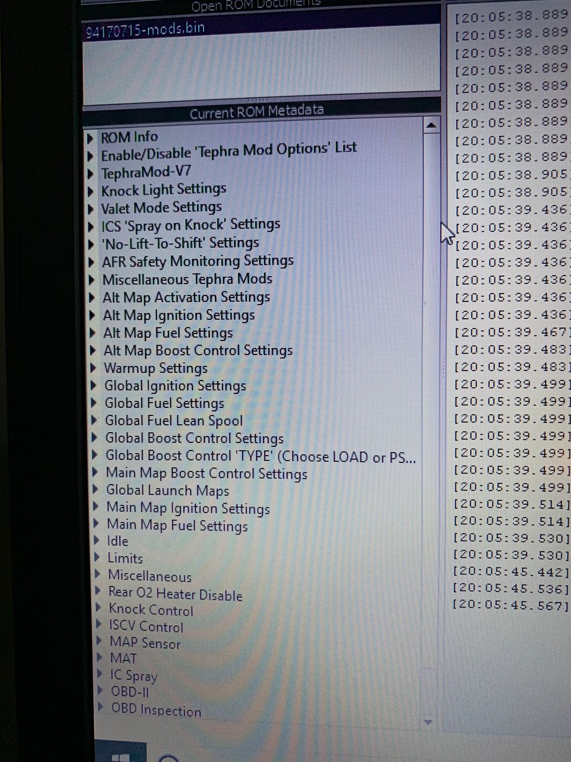

How’s this look?

How’s this look?
There yah go, now you should be able to work with all the features.

So does this come with the o2 simulator already enabled? Kinda looks like it if I’m understanding it. Also how do I know what’s enabled as far as all the settings in the column?Basically trying to copy over the stock 8 rom with the o2 simulator enabled so the cel isn’t on. Looks way different then the options on the stock rom with all the global settings an all.

Under the "Enable/Disable 'Tephra Mod Options List' tab there is an "Enable Rear02 Simulator" you will want to make sure thats set to 1. There is a whole lot going on with V7 that is different then the stock rom. All the info you need is in the ecuflash sub forum though. It's a lot to digest but worth the effort.

I think I’m getting the hang of it. Looks like lots of tables to edit under fuel and timing.
