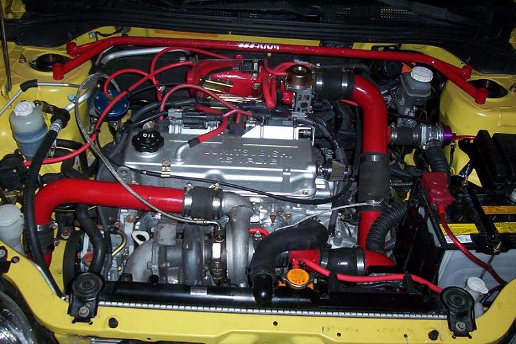

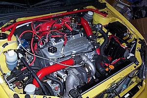

Well I installed my turbo about 2 weeks ago, have been working out all teh little tweaks and such. RRM and espicially Boe have been a very good help, even though I didnt buy this kit from them. I bought it used off of Dookie on these boards. There helping me as much as possible to get me running good. Thanks Guys
I put up a couple pics of my engine and a dyno/wideband test that i got done last night. These numbers are on Mustang Dyno.
I still havent pressurized my system yet, so I may still have some boost leaks in the intercooler piping, I did zip tie all of my vacuum hoses just now though.
My current engine mods are:
RRM Stage 1 Intercooled Turbo Kit/ Greddy Type S BOV
RRM Headers
RRM Intake Manifold
RRM Magnacore Wires
Green Pshycho's Bored Fuel Rail
Greddy Evo-Catback Exhaust
I think that's it....
Erik
Attached Thumbnails RRM Intercooled Turbo Installed-engine.jpg   RRM Intercooled Turbo Installed-engine1.jpg   RRM Intercooled Turbo Installed-dyno.jpg   RRM Intercooled Turbo Installed-afr.jpg

lol 133hp and 155ftlbs of tq? get your problems fixed and redyno. you get a good deal on your parts from dookie?

there are some issues with those dyno numbers, u need to check for leaks in the piping and vaccuum lines and all your gaskets.
Ya... I just zip-tied all of my vacuum lines, ALL of them. Gonna be testing the piping and gaskets later this week.
From what ive been told those numbers arent too far off. Supposevily Mustang Dyno can be up to 20% less then a DynoJet on 4 cylinders. Im also just running the stock 5psi

Mitsu_03... Got the EGT working? And we defenetly have to look into those numbers... Even though the Mustang dyno shells out lower numbers... that HP figure is kinda scary... I mean 133 at 5psi intercooled.... There's gotta be something wrong.
