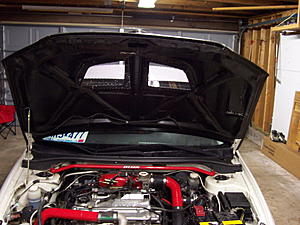

Done!
Finally...125 miles still taking it easy...

niice, only thing is that pipe from the turbo to the intercooler looks like its about to fall off the turbo...oh well, how does that greddy sound? that intercooler looks sweet in that front lip, nice work man, give us the details.

Pipe is not going anywhere... Sits crooked to clear the headlight. With headlight out sits straight but headlight pass through is very tight squeeze... Greddy BOV makes a weird "whoo woo woo" noise when it recirculates but when I get on it...wow...
A dude in a truck with a camper cut off my buddy, he had to pass on the shoulder... BOV scared the crap out of passenger in truck.. person litterally jumped when he passed em...
