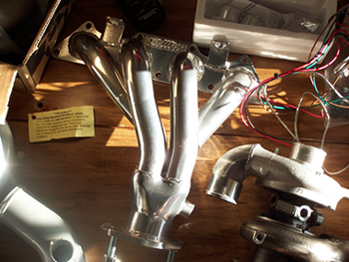

Heres just one pic right now to see if this is working...

oh yeah its working and thats hot

thanks to twardozrally for helping me post the pic, its a pain to get the rest up right now but hes gonna try to host them for me so hopefully more up real soon

i'll get more up between lively and tward, there may be some doubles but im trying to get them up as fast as i can cuase i know before i had turbo all i wanted was pics and stuff so i'm trying my hardest to get them to you guys...
Turbo, uppipe, downpipe, header assembly minus wastegate
Header and turbo

damm that is sexy! who makes such a sexxxxy kit ???

nice i needed to see how the intercoolr mounts.
