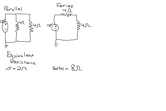

quick drawing (don't make fun) on parallel and series.

Ok sorry but the whole drawing messed my head...
Old Mar 11, 2003 | 10:11 PM
PaulysLANCER's Avatar
Joined: Feb 2003
Posts: 42
From: Albuquerque, NM
Ok it does make sense now.... took a minute to process....
