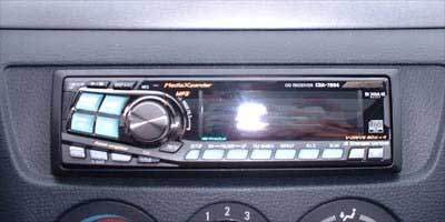

Old Mar 23, 2003 | 06:31 PM
digdat's Avatar
iTrader: (31)
Joined: Jan 2003
Posts: 1,048
From: Eugene, Oregon
heres what mine looks like .. I dont mind it sticking out a bit. When the face is off its flush and looks as if nothing is there. No gap i believe ..
