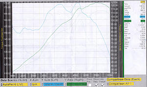

for anyone interested. here is the dyno graph from last weekend. we could not finish the tuning the emanage as i said before so go easy on me, as you can see there is alot of work to do. look at that torque curve?! my idle sucks too, it stalls almost everytime i stop at lights. WOT feels pretty good though.
this weekend it will all be fixed up and i'll post the new graph.
mods are: RPW headers, FSE rising rate fpr, 4g93 ported intake manifold, 60mm oversized throttle body, 3" RPW CAI, 2.25" exhaust, thermoblock intake manifold gasket.
hey Shaun, what work are you getting done?
stage 2 camshaft & valve springs will be my next mod also so you might still have some catching up to do
i'm going for 150hp atw before the end of this year.

wow look at that dip at 4k... looks good though... at first i was looking at the left side and i was like DAMN... lol. Make sure you post it in the dyno thread. Keep us posted
