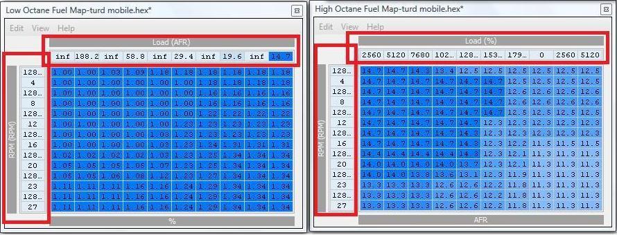

Im trying to edit my ECU data and it i difficult to understand when i cant read the values... this is a pic of what it looks like maybe there is something im forgeting or idk im new to this maybe someone can help...

I look on the tutorials and the numbers look normal... but mine do not idk... lol... just my luck...

Now I haven't looked at ECUflash in a little while, but those values on the header columns and rows don't look right at all.. did you get the correct rom for your car and make sure it is in the right folder and such?

You might need to change the endian value for the RPM and Load scaling ...
Right -click any map/table in the left column
Select edit map
Click the Scalings button
Select RPM or Load
Click Edit
Change the endian value to the opposite of what it is ... little to big, big to little
Click OK, exit, apply, OK
Check the map and see if it's correct
Old Jul 20, 2008 | 10:32 AM
bigern2006's Avatar
Posts: 73
From: canastota
OMG it worked Thanx so much now i can tune.. yeay.. thank you again...
