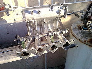

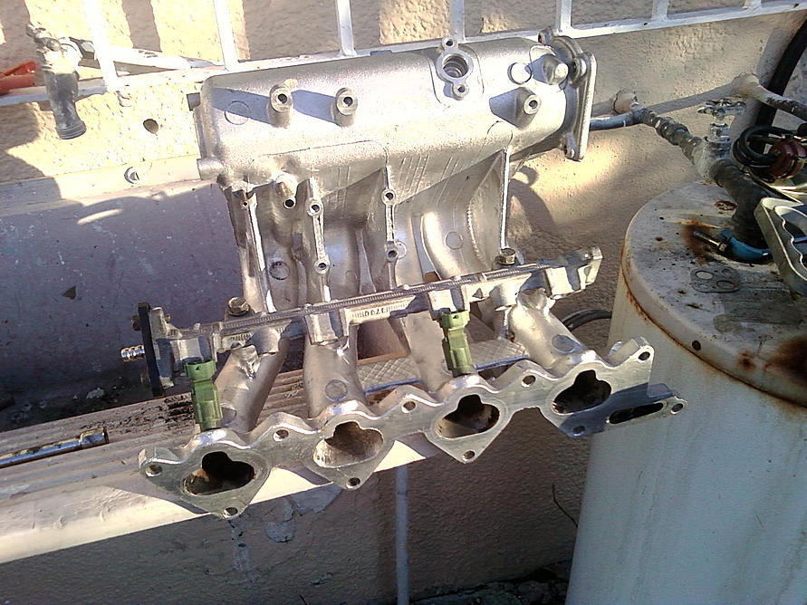

the is 1.8L 4g93 manifold
http://images.ibsrv.net/ibsrv/res/sr...e_thumbsup.gif
Apexi NEO
injectors wrx 440cc
I have in my car
