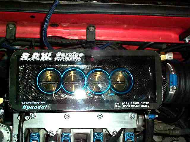

Does the quad TB give each cylinder its own tb and separate intake runner? Or is it just 4 tb's filling one common intake manifold? I've never really seen much info on them.... but a lot of people here seem to be talking about them.

4 individual throttle body's going to each intake port

Yep, it's similar to multi carb setups on muscle cars.

thats what my main ? was, is it even possible to run a quad tb with a turbo? if it is the piping n stuff has got to be a mess

Possible? Sure! Practical? Hell no.
So 4 tbs per to each intake port times 8 intake ports is 32 tbs? Just kidding.
I'm assuming you meant the 4tbs, one per cylinder, no common manifold (after the TBs, obviously that airbox makes a common plenum).
