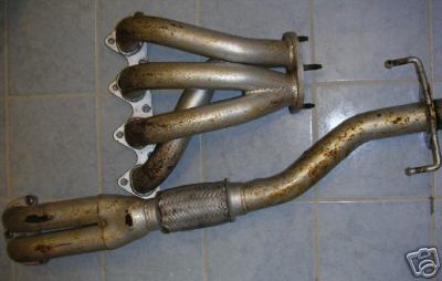

I was told this is a Megan Racing header and downpipe combination for 02 Lancers.....anyone know who makes this, if it looks like it will fit, and if Megan Racing even makes one for our cars???

ummm it doesnt looklike anything ive seen, a guy posted earlier about megan racing header that he bought so i guess we'll see how it turns out

Thanks Rigo, cause I know of someone who is selling this... I didnt wanna waste my time and buy something that doesn't fit.

Thats not a bad header but if you look you can see that number 1 cylinder goes all teh way across to merge with no 4 cyl.
The length of the pipes are varying which emans each cylinder is not going to pulse / extract evently.
Additionally every time a set of pipes merge they lose air flow and become restricted something to consider.
Its well proven on the lancer engines that properly designed 4-1 long tube headers work wonders.
If you check vendors at this moment you will see smoe great deals on teh RPW 4-1 systems with downpipes.
