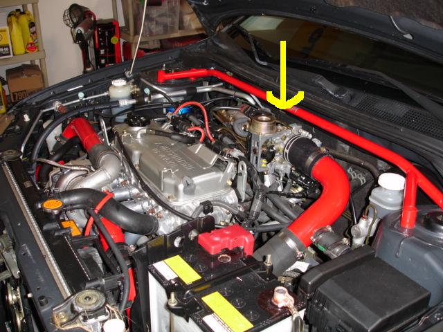

on top of the throttle body is a rubber plug. take it off and turn the little screw adjuster with a flathead screwdriver.

Although I'm still confused why I have to adjust it. The position is the same as it was before. Thanks man, I'll check it out...
