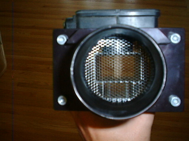

Hey Rhyz have you tried this yet? If you cant tell this is a restrictor plateless MAS. Safc cant compensate enough to keep up with the air, +50 and she was asking for more at 1 and 2k. I quit right there and put it all back to just the backed out screw trick. Im gonna have to root around for that fuel pump that you have. I obviously need more gas.
