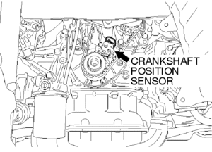

Ok, I took off the plastic cover and I don't see any sensors anywhere
The only electrical harness is the connector you see in the photo, it leads to somewhere under the block.
Is it on the bottom half of the engine block ?

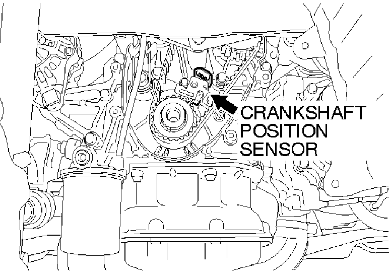

Not easy but its doable, just be careful as SLVROZ_03 said with the wiring, this is where the sensor is if you still cant see it
