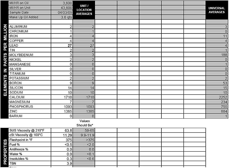

heres mine.
Amsoil Dominator Series 10w-30
3,600 miles

Originally Posted by 4g94T
heres mine.
3,600 miles
Hey brother, did you ever had an analysis done before the dominator ?
Watch that silicone number, they ususlly get high when your filter is dirty or time to change, watch that lead content the lead number is concerning @ 27 PPM.
No, I do not. This was my first oil analysis. I wanted to see the TBN of RD-30 after ~3,500 miles and also what was going on with my oil.
Lead is really high. I was running high boost though...
I did not use any fuel additives so Im guessing its my bearings
TBN of dominator is by nature mild, no reason to have high TBN's on racing oils as you know because they are racing oils, if you are in search of a nice high TBN number i reccomend you use our ATM 10W30 or our SSO 0W30 they have 12s and 14s
i think you are right on track, lead is only contained in the beraings that iam aware of.
high boost wont do the lead content other than hurt the bearings,,, that prolly what you meant,,, now my question is did you run any leaded fuel, iam sure you did not otherwise you would have mentionned it.
id say you run another lab and see where your numbers are at.
ill pull some other data and try and compare to.
however i can tell you that right now i have an AUTOx evo ix that we sponsored, he is running some very hot laps prolly hotter that what you are and his numbers for metal content are all looking in the 1-3 PPM area.
The first 6 numbers on the report wich are the metals that are used inside our engines are very critical the most important ones, if any of those go above 15 one needs to start watching it.
i reccomend you run another analysis report here soon but use a different lab just as a second opinion
i have kits that can ship out for 25 bucks with prepaid USPS postage.
Thanks.
I will run more analysis once I finish rebuilding my engine and it is broken in.
I was going to run another analysis before tearing my engine apart, but I thought it was not worth it since I will be replacing everything anyways.
I will continue to use RD30. (will this oil be okay for breaking the engine in?)
Thanks.
Yes you are perfectly fine using RD 10W30, just remember that the RD oils are meant for racing therfore they require to be changed lots quicker than our other lineups like the ATM 10W30 and the XL 10W30
i would not let the RD oils run anything above 2500 maybe 3k, thats just me oil analysis might prove me wrong though
