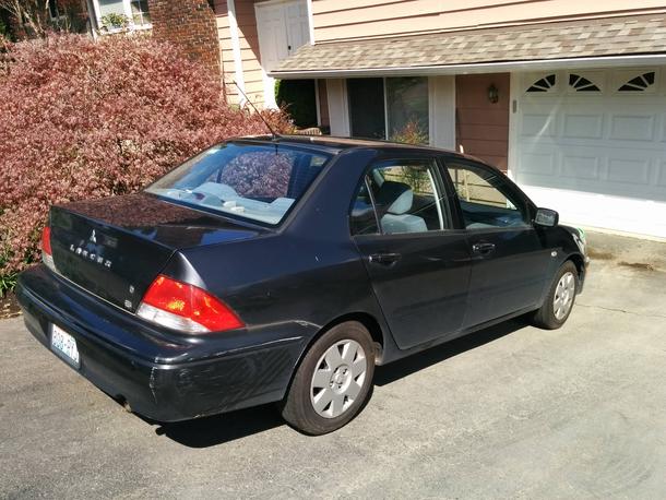

Here are some current pics of the car:
Attachment 331567
This is the biggest body damage: https://i.imgur.com/kaOuX1h.jpg located between driver side doors.
