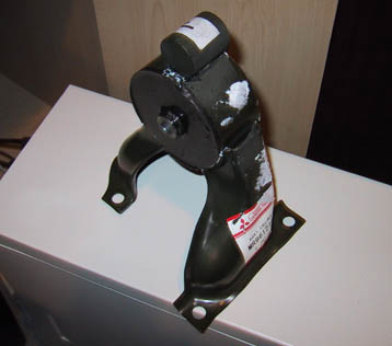

Front mount:

That's as they arrived from the box. These are firm mounts with black filling (you can choose the PU color last I checked). Stock mounts, DMR fillings. I've been nothing but pleased with mine...in fact I think they're the only things that kept my turbo from pushing through my radiator and heat exchanger.
