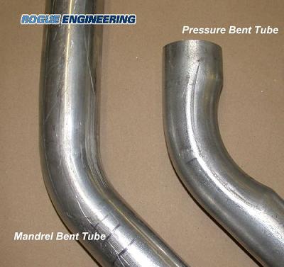

Yes, Mandrel bent tubing is the same width through out the entire piping. Pressure bent piping gets smaller around the bends. However, mandrel bending is very expensive and the machines to do it cost a quarter of a million $$, so dont expect a local shop to have it.
The main difference is that since pressure bent tubing shrinks, you actually get a smaller tube than 2.25, maybe 2.00" around the bends, so you get less air flow. Mandrel bent tubing doesnt shrink, so there is no decrease in air flow.
Go here to find out more: http://www.rogueengineering.com/Merc...gory_Code=BEND
Here's a prime example...
Will thay pressure bending really make a difference? No one here locally can mandrel bend, so should I go with a 2.5" pipe so when bent, is more like 2.25"?
