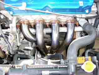

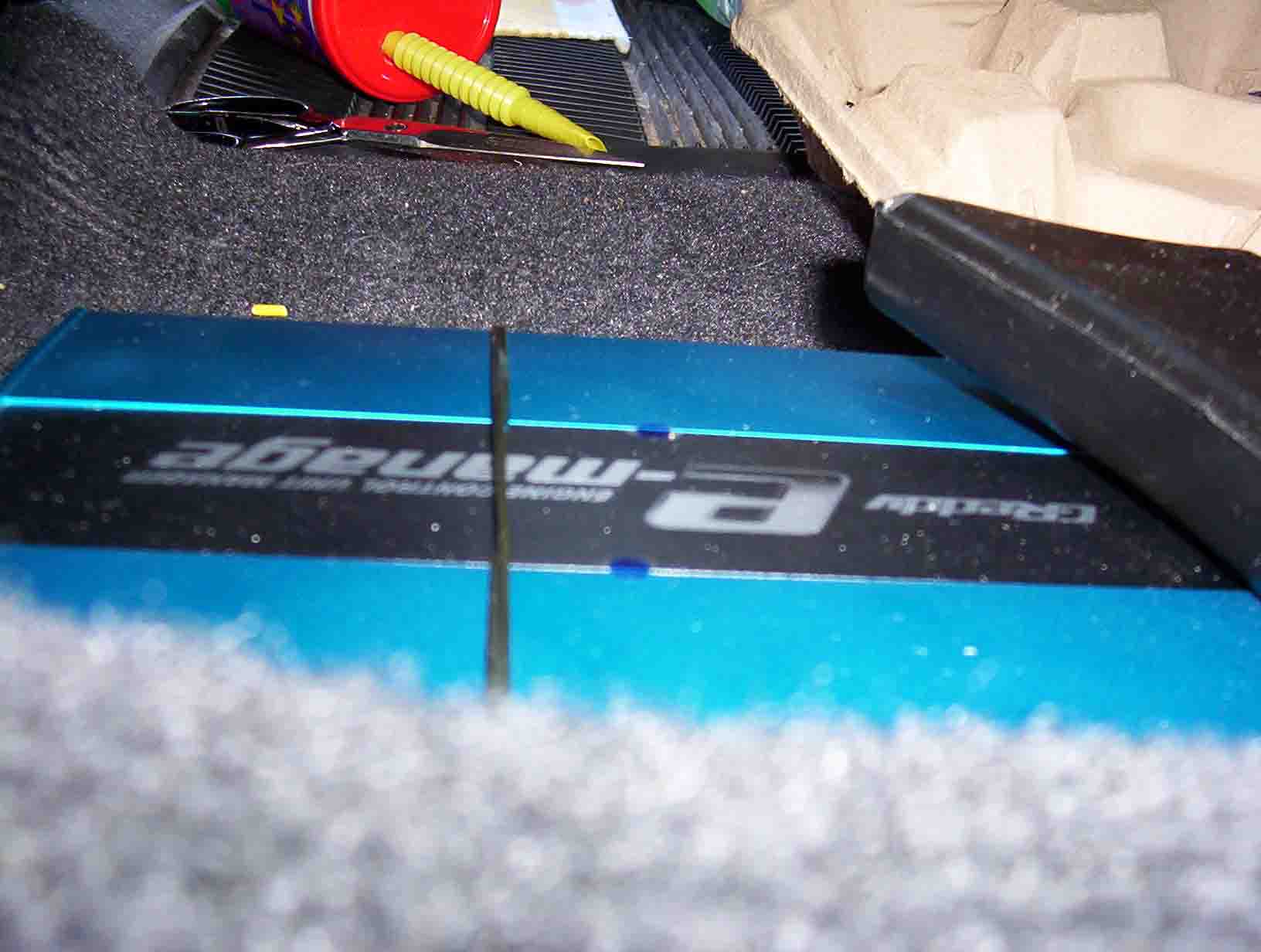

I was bored this week so here's my new mod.
609 MAF, OBX Header from a 1.8L Mirage with custom 2.5inch down pipe and highflow cat. And the best mod yet E-Manage with timing Harness. Any one who is considering the mirage header, it drops right in and bolts up to the head but the down pipe will not fit due to our lancers oil pan. Tuned the setup with a wide band and palm 4g94 can take alot more timing advance than the stock parameters are set at. People were saying they lost low end response with a header. I drove with just the header for a few days and noticed that too. But with the MAF and E-Manage the cars responds
is excellent.

Sorry forgot to mention Ralliart Grill and engine front mount from a Evo, stonger mount, mininal engine rock and no vibration in the wheel at idle. going out now to see if wheel hop is reduced. I'll let you know.

Very tasteful mods! Glad to see someone else using the emanage to tune the Lancer. PM me and let me know more about the timing harness (ignition harness?) install and tuning.
