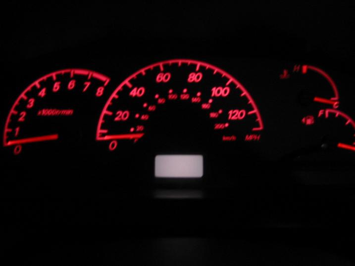

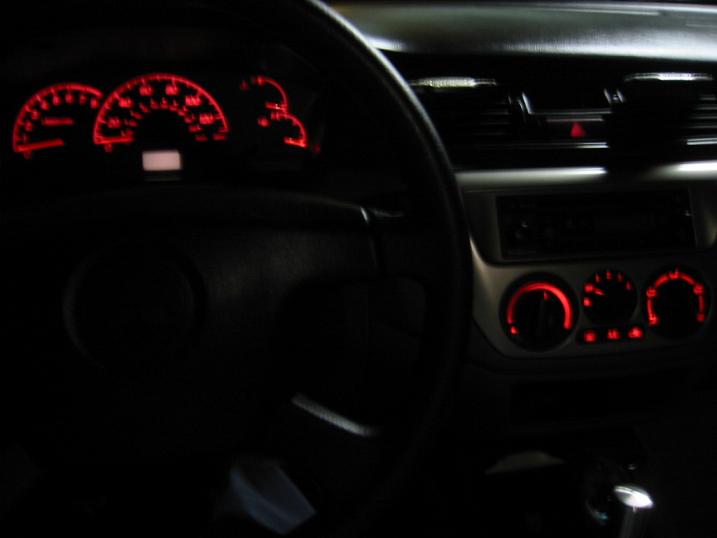

pics: there are actually a few bad things about this, first its that the AC faceplate where u adjust the coldness (blue part) also turned kinda redish... and that the needles on the gauge cluster are also red so its kinda confusing when u glance it at sometimes.

OH for the gauge cluster i didnt use the blub caps, i took off the blue cap, sanded the bulbs and painted them with permenant marker for 5 coats. It will fade eventually, but it will last until i get some real red blubs. here's one more pic

sorry my camera sucks when taking pic of dark environment... and i cant hold my hand steady enough
