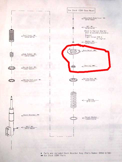

actually I was completating on these too...i'm not a noob and I did search (hehe)...but i'm still a lil confused.
To make OZ springs work on the Es suspension I read....
oz springs on es = Upper Spring perches
coilover setup on es = Upper strut Mounts w/ bearing
Can someone point out on this picture which is what???

well basically on the picture, on what's circled is the upper MOUNTS and BEARING, so is the thing under it the upper SPRING perch?
and that's all I need to get OZ aftermarket springs on my ES suspesion?
the parts you have circled are what you need in order to fit those coilovers. then im sure you would need them as well as the upper spring seat if you want to fit oz springs. but im pretty sure the entire shock is different so you would have to replace the whole front setup.
