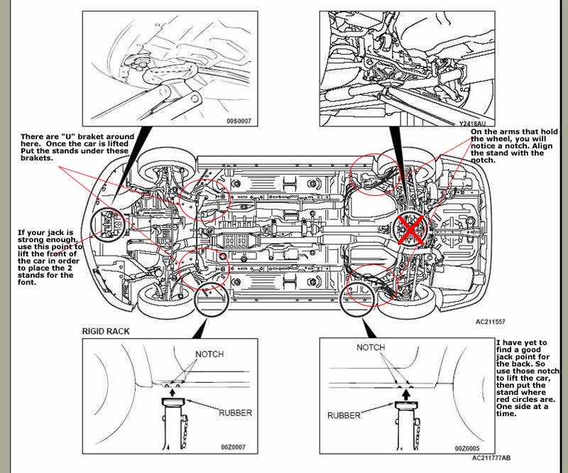

I decided to finish removing the paint off my wheels the same day, so I finnaly went with the 4 point lift. The procedure was a breeze.
For those who don't already know, here are the proper jack points for your Lancer.

i have a question, but decided not to start a new thread.
if i where do i put the jack when jacking up on side of the car. i put jack stands onto the place where its supposed to go, so i cant put the jack there
Thanks for the diagram, but the jack point with the big red X won't work for our cars because we don't have AWD. What jacking point are you guys using to lift the rear of the car before you slide in the jack stands?
