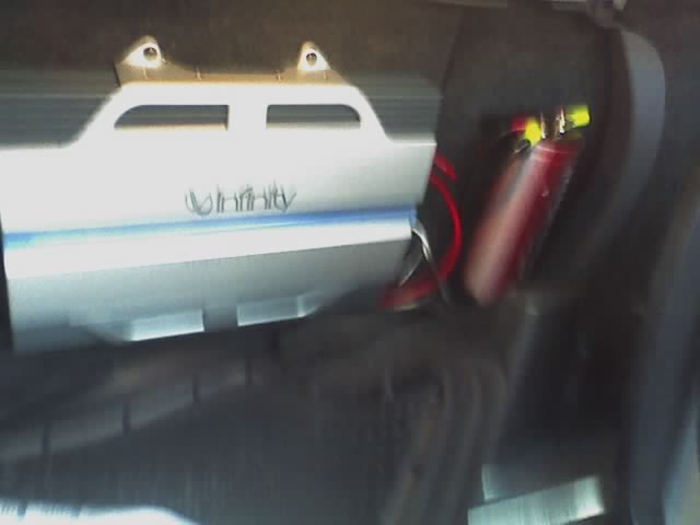

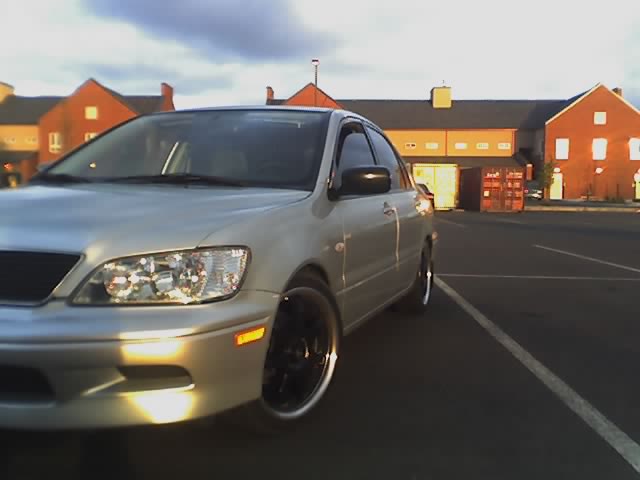

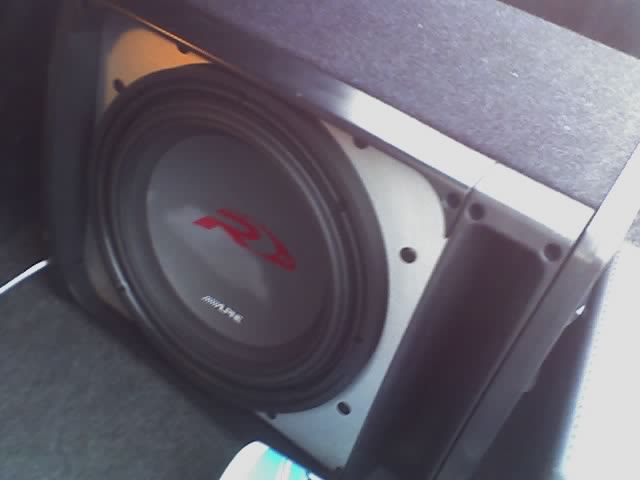

just thought id get some pix up thanks for the feedback
