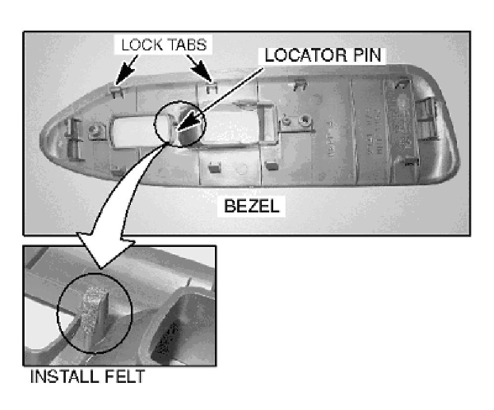

a. Vibration at window switch may be caused by:- Window switch bezel lock tabs contacting the door panel.
The door panel fabric may be improperly positioned under the panel trim. This condition allows the bezel lock tabs to contact the trim panel and causes the vibration noise.
Remove the window switch switch and bezel. Fold the door panel fabric neatly down around the trim opening.
Reinstall the bezel and window switch securely.
- Window switch bezel locator pin.
Remove the window switch and bezel from the door panel. Remove the switch from the bezel by removing two screws. Install a small piece of felt around the locator pin as shown
Then reinstall the window switch to the bezel, and reinstall the bezel to the door panel.

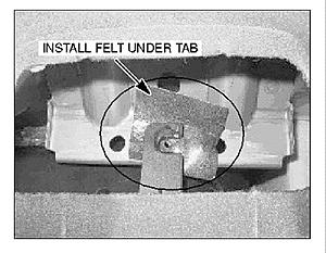

b. Vibration at the grab handle may be caused by the plastic tab under the grab handle.
Remove the grab handle. Install a small piece of felt under the plastic tab in the opening as shown. Reinstall the grab handle.

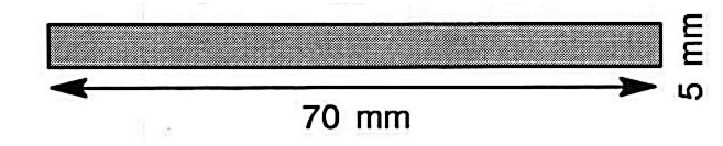

3. Obtain adhesive-backed thin felt material from the BSR kit listed in the PARTS INFORMATION section of this bulletin.
Cut six felt pieces, approximately 70 mm X 5 mm.
4. Remove the liner from the back of the felt pieces. Affix the felt on the inner clips as shown.

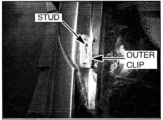

5. Be sure that the outer moulding clips (four on each side) are securely attached to the body retention stud as shown. If the clips are not properly attached, noise may result.
